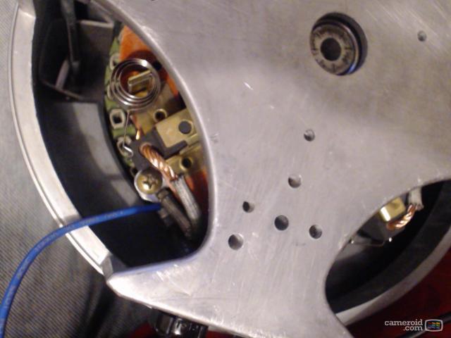

One of my personal electric motors:
"The books are to demonstrate the theory in as simple and clear a way as possible.
Just to be sure we understand the neutral point:
Consider a simple armature. The conductor goes from a commutator segment to the core. It is wound around a rotor segment several times and returns to the next commutator. When that pole is midway between the field poles and is travelling parallel to the lines of flux, so that no voltage is developed in the coil, it is at the neutral point.
What is important is the position of the rotor pole.
Trying to draw the commutator offset in a simple drawing may add unnecessary complication."
THANK YOU SIR!!! That is exactly what I needed. I gave you a star. :)

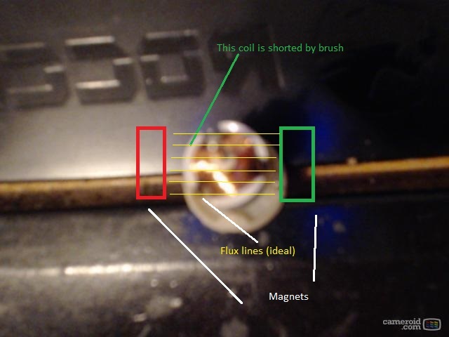

Now how about the special case when 3-pole armatures are used? I've found that a coil is shorted when the pole is directly in line with a magnet stator pole instead of between the poles.
http://www.precisionmicrodrives.com/uploads/media_...
Every three pole armature I found shorts two comm bars with one armature pole is facing directly perpendicular to a magnet. Is this a special case where they cannot avoid shorting a the coil when its at maximum generated voltage? Or do I need to look at the fact that the coil of wires will be parallel to the flux lines produced by the stator magnets? Or perhaps the flux lines are distorted and they accounted for it?

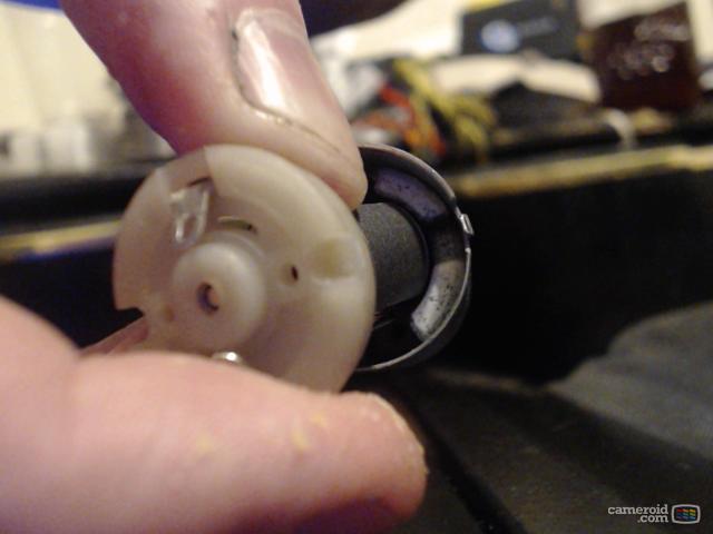

Here is a picture of what I am talking about:
RE: Confused about DC motor neutral plane from theory to real world observations.
I suspect that the brush position shown in the drawing is 90 degrees from where it should be.

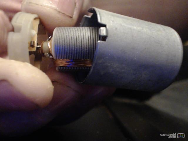

Here is how it goes in:
You can see two comm bars shorted by that brush and the coil that connects to those two bar.
