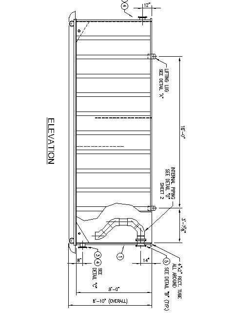

I have a rectangular water tank with weir plates inside. Water flows into the tank at "X" gpm through an inlet nozzle. Water flows under the first weir then over the top of the second weir and then exits the tank through and outlet nozzle. I would like to maintain the level in the tank at 12" down from the top edge of the tank. The inlet and outlet connections are both located toward the top of the tank. I'm trying to determine the proper location (height) of the inlet and outlet connections so that when flow stops, water doesn't back siphon out through the inlet connection. Is there a formula that will calculate how high the water will rise inside the effluent nozzle as it starts to flow out of the tank? I'm thinking wherever that water level is, will be the operating level of the tank. To prevent the back siphoning, the inlet nozzle should be a few inches above that water level. Can someone give me a little guidance with this? Much appreciated.

Draw your tank in elevation view, approximately to scale with the centerline, top and bottom of the two proposed nozzles indicated. I think there will be a nasty air trap in between the two.

I would not recommend a pipe on the outlet. What happens with a pipe outlet is that you will get air trapped and the fluid flow will transition between full flow and partial full flow. With trapped air, it will block the flow, so you will get fluid surges until the air is pushed out. With a horizontal outlet, it is also difficult to maintain the elevation.
If you want to control the elevation of water, you will need to put a wier or pipe elbow to the water surface on the outlet. You may oversize the outlet, so you do not have to worry about full or partially full.
You need a vent on the inlet pipe or shortened leg, otherwise, the inlet pipe will back siphon out of the tank.

We really need to see what happens to the inlet pipe away from the connection.
If it goes up, but the inlet nozzle is not fully submerged, you won't get a syphon effect on cessation of flow, more that the inlet pipe will drain out.
Much depends on this orientation and velocity of flow in the inlet pipe.
Anything less than 1-2m/sec and it probably means your pipe isn't full.
what is this? - some form of API separator? If you have no other outelts I don't see what the second weir is doing for you?, noting that's it's not really a weir, just a baffle plate as the liquid level is much higher than the weir
Is the tank atmospheric? - where are the air vents
Ditto as bimr says for your outlet pipe. You could either end up with a syphon or an air lock / bubble if there is something connected to this outlet.
Why the internal pipe? you seem to be complicating things by having that strange internal pipe.

The tank is atmospheric (open top) and used as a Coagulation/Flocculation tank in the water treatment process. True, what I called weirs I suppose are really baffles. Moving from left to right, Coagulant is added into the first chamber where there is a high speed mixer to disperse the chemical. Water continues past the second chamber and over the final baffle where the flocculant chemical is added and a slow mixer allows the floc to get larger. Water floc exit the tank and goes to a clarifier.

Standard practice would be to enable a syphon break at 11ft or so below the top of the tank. This can be a simple as a 1/2inch weep hole on the top of the inlet line.

Sounds like the whole thing is gravity driven. In which case the outlet invert will need to be lower than the inlet invert. Otherwise, when the influent ceases to flow, it will stop within the inlet pipe itself.
I usually deal with grease/oil/dirt interceptors, not what you are trying to separate, and the outlets are typically 1-2 pipe sizes below the inlet. This allows the inlet pipe to empty when there is not flow.
