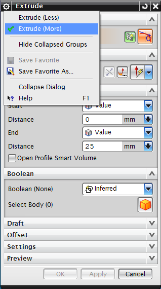

NX10.0 extrude window not showing draft/offsetting command
RE: NX10.0 extrude window not showing draft/offsetting command
Click on the little gear icon in the upper left corner of the dialog and choose the "show collapsed groups" and/or the "extrude (more)" setting.
Try clicking the gear wheel at the top of the dialog and choosing More:
