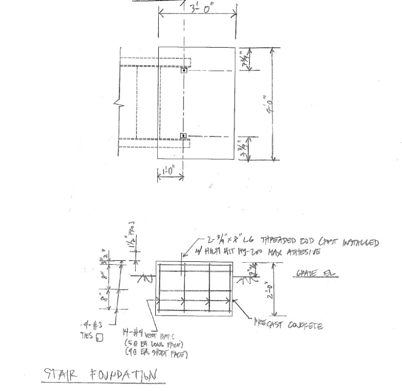

we will be using precast concrete instead of cast in place for the stair foundation.
i just said precast concrete in the drawing.
is that right? the contractor will find a precast vendor for this foundation?

You can either specify pre-cast concrete designed by others, or show the reinforcing and dimensions. Not both.
If you are expecting the pre-cast to be designed by others you must provide the applied loads and the intended anchorage of the stair above. I would also ensure that the appropriate foundation design information is there (bearing capacity).
That being said, why? It's much tougher to hit proper elevations and leveling of the block when compared to a cast-in-place option. I fail to see how a pre-cast blob of concrete is a more economical and constructible.

Project manager wants precast and doesn't want any cast in place concrete on site.
Will my drawing work (as far as purchasing this precast concrete block)?
This is just a small stair foundation.
I already provided the rebar and concrete size for the precast vendor.
No need for them to re-design it.

The 2' dimension, A.B’s. to front edge of ftg., in front of the lowest tread, is not enough length in the direction of travel for a landing or stoop. Make that dimension the same as the width of the stair treads. So, the ftg. will be about 2' wide, not 3'. Check with the local AHJ, they might hassle you about what you show in your sketch. I agree with Jayrod12. Making that ftg. precast and then trying to place it properly in orientation and elevation, seems difficult to me, in comparison to a cast in place flg./slab, with a couple A.B’s.

How will the contractor achieve a level bearing surface so that it does not settle unevenly? I agree with others that it does not make sense to use precast for this item.

Anyway, I'd favor using something else for the landing and hide the precast grade beam (1'-0" x 4'-0" in plan view) behind the landing. With a nice long threaded rod epoxied in, you should be able to get all the tolerance you will need for final installation. Let the precast sidewalk guy figure out the landing!
Might not need any reinforcement for this foundation.

This seems like an incidental item, so it will depend on the precast company. If you do not require them to issue a sealed drawing, I suspect the information you have shown is sufficient. If they are a PCI certified plant, and you require a sealed drawing, then they may ask for the design loads. The precast company we work for has built parts to the engineered drawings, but in those cases I have never sealed the drawing.
As for leveling, that can be done with sand or fill-crete. Since the stair has steel risers I would expect the contractor will make up the difference in grout under the stringer. Still seems like more work, but whatever the client wants.

I'd go with jayrod's suggestion, either show the rebar and have the precaster build it as you've drawn, or require the precaster to design it in-house. They're probably going to like it better to design it themselves than if you detail out the rebar. Another advantage of precast is you'll typically get better concrete than cast-in-place on grade.
We do a number of jobs like this for regions where there is poor access. Shouldn't cost much more for precast vs. CIP to make a difference to the budget.

You could place this foundation on a prepared gravel bed. If you have the equipment to lift and place, you can lift and level as well. Keep a level instrument on hand. Place the footing a little low and put something on top of it (non-concrete, maybe precast pavers set in sand) to make a level landing.
Put more lifting inserts in it, though.

delagina - One stupid, simple question: Does this CM have equipment on the site to place a 3,600 lb (2' x 3' x 4' X 150 lb/cf) block of concrete in the correct location?
Seems to me to be a bit oversized at 2' thick.

I am curious about the reinforcing shown. It looks more like column reinforcing rather than a slab or matt. If this is exposed to weather, I would specify galvanized or stainless steel anchor. Did an architect specify the plan dimensions? If there is no pavement or pavers around the concrete, it will be similar to a step with a 24" run and 3.5" rise.
The PM may be concerned about scheduling. No waiting for cast-in-place concrete to cure. (not that this is a good reason, just it is a reason)

Have you considered the "pushing" load that will be exerted on this small precast slab? The bottom of the stair section will have a relatively high lateral load from the stair loading. This will tend to "push" the slab unless restrained by a walkway or other obstruction.
RE: stair foundation precast concrete
I changed to CIP and just put a note to use precast concrete if CIP is not possible. Let the contractor decide.

we have the equipment necessary to hammer timber piles, to lift a shop-fabricated platform but we can't do CIP. So yeah, PM logic may not be right here. Honestly, he is also not so sure. Platform and foundation will be located in swamp area.
