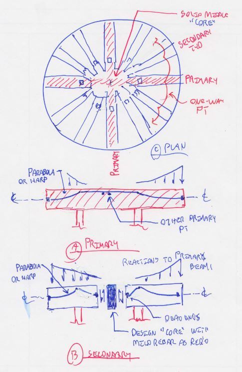

Hi Good Day Everyone,
I've got to propose PT layout for above circular PT layout for a residential building with 12m cantilever on each side (Columns are only allowed on inner circle perimeter). I am thinking to propose as above but if that so except the rebar & tendon congestion @ the center of the circle, there will be a lot of pre-compression (P/A) due to PT & a lot beam design will share the section. It is my first time to encounter this kind of layout.
How should I approach, analysis & design? Thanks in advance for your help.

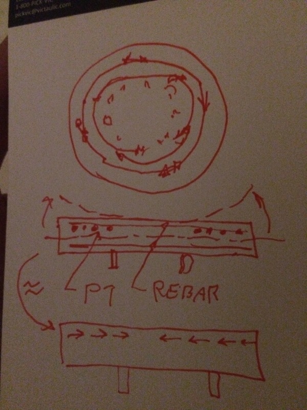

Oh. My. Goodness. I would cut off a pinky finger to switch places with you this week. I'll throw my hat in the ring. See my proposal below. I'm torn as to whether or not there should be a little hogging in the primary girder cables between columns. Maybe FEM can point you in the right direction in that regard.
RE: PT Circular Floor
Another intersting consideration is that your circumferential PT should help to create your radial prestress by virtue of the circumferential PT in the slab always being above the centroid of your girders.

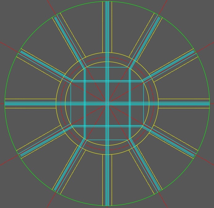

KootK,
Thank you for always helping me out.
I think there definitely will be hogging @ center.
Actually I have almost same idea as yours except my secondary beams are not continuous as per sketch above with one cantilever & 10 m back span. Yours is better :). In your proposal, I understand how to design every individual secondary beam with core at the middle but since the core is shared by many beams, frankly I have no idea how to design & consider the combined effect & never done it before.
BTW, I am using 2D frame analysis software.

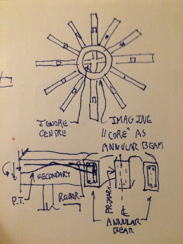

No sweat. My wife's away on business so it's either this or spend time with my kids.
I'd conceptualize an annular beam within the core picking up load at the secondary beams and dropping it off at the primaries.

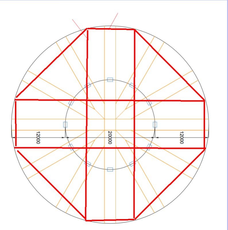

Radial is not very good for this. There will be 6 layers of reinforcing and prestress at the centre. And then your slabs are radial as well.
2 parallel beams in orthogonal directions over the columns either side of the centre, beam across the ends at the outside edge the edge (they could follow the edge but will be easier to build and be more efficient if straight as shown)) and secondary beams if you want to reduce slab spans (possibly 2 in each direction but probably not needed with the straight edge beams), all parallel to the other beams. With those extra beams if would probably be possible to do the slabs as RC only.
This allows orthogonal prestress in both the slabs and the beams and a sensible centre zone where the top steel doesn't extend half the depth of the beams.
And you can get rid of the rest of the columns.
And this is actually buildable!

Top marks to rapt, but i would stick with a pt slab at 12m spans and a orthogoal grid on the beams as suggest by rapt. Or add some extra beams in the ortho directions

@Struggle66: I agree with rowing, Rapt's solution is the most constructible so far. Curious: is this a one off slab or a repeating floor? Will the underside be concealed or exposed to view?

Quote (Struggle)
My secondary beams were also not continuous with respect to the PT. If you look closely, I was proposing to dead end the secondary beam cables just shy of centre, the same as you.

Rapt,
If there is an annular beam as KootK suggested only two layers of tendons & reinforcement will be crossing at the center. But anyway, I'd tried your proposed layout, before I went for radial layout. Now my radial beam depth is 600 mm at the tip of the cantilever & 1200 mm at the column. I think I am gonna need deeper beams in your layout as there are point loads from secondary beams at the tip of the cantilever & lesser beams which is not possible for my floor height.
Agree it is simple & buildable. I am gonna try add more beams in your layout.
