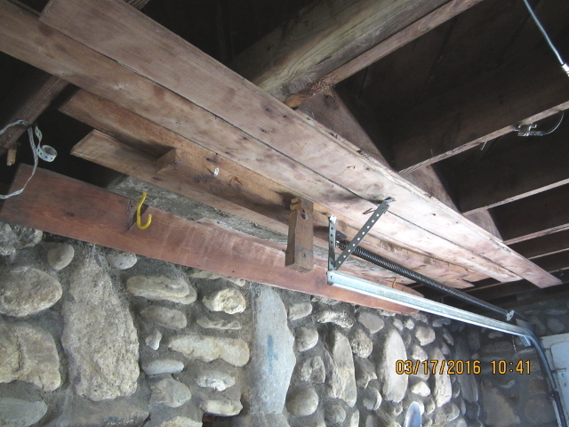

They looked at a wood-burning stove but it stuck out too far into the room. Once I'm done with that slab, it better not move any more :D They didn't realize it but had used the hearth framing to also support the garage door track and to hang a 20' ladder. Both of those will be removed and the framing strengthened.
I'm considering removing all the cracked up flooring in the fireplace and then repouring, but yes, that crack moving more would be the main concern. I like that pan/lining idea a lot. Thanks!

Hearth is framed around by double wood joists with wood below, and concrete poured above. The garage door was supported on this. The framing in this area has sloped down and away towards the middle of the house, creating the crack. see:
Not the best pic, but look hard and you'll see the left double joist (with a ledger stuck on it so it looks like 3), the flat horiz boards under the hearth concrete, tracking for the garage door, the header between the double joists at the end of the conc hearth, the shortened joists, and the yellow hooks for the ladder. You can also just see the top of the cleanout in the river stone wall at the bottom left-middle of the pic.

If you haven't ruled it out, I'd suggest you check the condition of the joists at their bearing. In the first photograph, on the right, it looks like there is a gap between the baseboard the flooring. It may be that there is some rot at the joists where they sit on the stone and a subsequent drop in the joist elevation along this wall.
