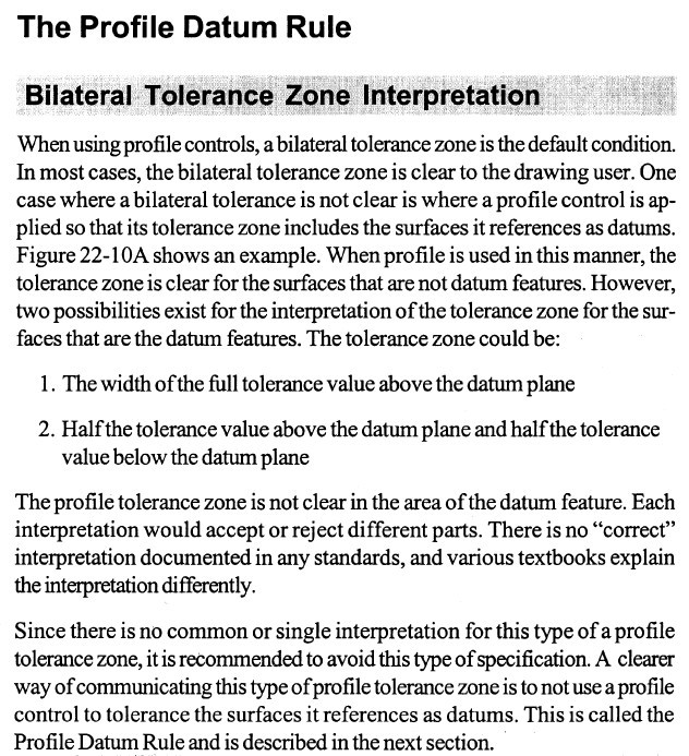

RE: Self-Referencing datums; all around profile (REF: GDT Question thread)
Profile Datum Rule Quote from Alex Krulikowski "Advanced Concepts of GD&T" page 22-12.
Or use an unequal profile zone.
dtmbiz,
I think I owe you a reply here.
First, before I refer to some of your statements, I would like to say that I agree that the tolerancing scheme shown in OP sketch in the referenced thread has been overcomplicated and most likely could have been modified/simplified (by removing datum feature B and C references from the all-around profile callout) to look much more traditionally and without risking too much that function of the part would have been grasped improperly.
In general, I also agree with you that referencing datum features in a FCF that includes them in that FCF's geometric control should be avoided (wherever possible), however you statement:
Quote (dtmbiz)
Even though the standard does not specifically prohibit this practice that I can find, the standard does not appear to support this practice in the text, figures or intent relative to the DRF concept. IMO
is not fully correct. There are at least two examples in the Y14.5-2009 showing otherwise - figs. 4-25 and 9-7.
As for SeasonLee's example taken from AK's 'Advanced Concepts of GD&T' I am guessing it comes from a pre-2009 edition of the book. I am curious if today, in 2016, the author would wrote the same knowing that in 2009 the Y14.8 gave the interpretation (using datum targets example). So it is your full right to agree with option #1, but it is the option #2 that actually has been documented in any ASME standard. Unfortunately not in the Y14.5, which I think is the main issue here.
