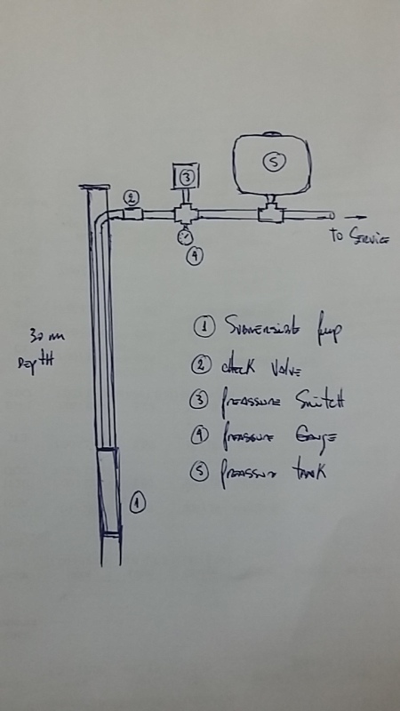

What will happen in a submersible well pump installation containing a pressure tank at the top (floor level) if the air in the pressure tanks leaks off (not air at all)?
RE: Submersible Well Pump question
The same as any other pump would behave when the inlet head reduces because of reduced inlet pressure into the pump.
A sketch would help a lot....

the air I am referring to is the air precharged in the pressure tank (5)

the pump works 24hs a day with out stopping even when nobody is using water (this is a house installation)
The pressure never reaches the cutoff pressure set at the pressure switch (4 bar). Pressure stays at around 3 bar all the time
If pressure tank has a precharged 0 bar (no air) the the pump will start and stop very often (as you said LittleInch).
I think that there is a 2nd problem here (besides no precharge at pressure tank). I am suspecting that the pump is spinning at the wrong way. Does submersible pump have spinning direction or they work the same in both ways?

The options are:
Your pump is either spinning the wrong way ( only really possible if you have three phase supply),
Your pump is undersized for your requirement (cannot reach 3bar at no flow)
Your pressure set-point is too high ( reset to 2.5 bar?). Why is this so high? for a domestic propert you don't normally need 3 barg
Your pump has a fault
Your electric supply is the wrong voltage or frequency for the motor
Does this help?

I think that it is spinning the wrong way. Tomorrow I will change rotation direction and see what happens
Just change over one pair of the three phase wires, I think to change the rotation. Don't know how you'll see the rotation of a submersible....
Let us know how it goes. Sounds like it might be the answer - typically you'll get about 60-70% of the proper head by spinning the wrong way so you should get about 5 bar?

I checked direction of rotation. Pump is spinning correctly

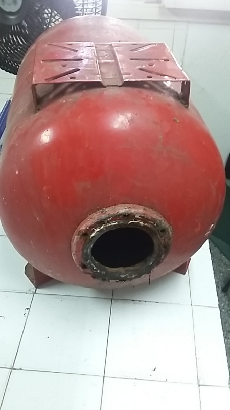

Pressure tank: Has no air at all. I have dismounted and disassembled the tank. The bladder is good
Pump works with out stopping and pressure stays at 3 bar

This is the tank: LS H 60
http://www.varem.com//pg.asp?cd=1014&mnpath=/0...=
I am going to precharge the tank again, install it and see what happens

If the bladder is good, where has the air gone?

Air must have leak out through the air valve. I changed the seal of it
I have installed the pressure tank and the pressure still does not raise above 3 bars. I reset cut OFF pressure to 2,8 bar and cut ON to 1,0 bar. The system seems to be working good so far but pump pressure used to reach 4 bar.
I dont know who or why it was set to 4 bar
I dont have the pump curve. All they could told me is that is a 1 HP SAER pump

yeah. I think the same, the only thing that remains to be corrected (change) is the size of the pressure tank because pump ON time is only 10 seconds to get from 1,0 to 2,8 bar. Seems to me that the tank is small for this pump
Pressure tanks is 60 liters and only half of it is filled with water (estimated)
Precharged pressure is 2 bar (I should lower precharge pressure to get more water into the tank)

Prior to operation, with the tank, empty of water, the pressure should be 2 psi below the cut-on pressure. So, for example, with a 30-50 pressure switch (factory default setting), air pressure in the tank will equal 28 psi. If the pressure switch is adjusted to 40-60 psi, the cut-on pressure will be 38 psi. Set the pressure switch to reflect a 20 psi differential between cut-on and cut-off. If the pump cycles too quickly causing the pump to cut on and off, setting the pressure switch to a higher on/off setting should slow down the cycling.

The turn-off pressure setting should be set about 5 psi lower than the deadhead pressure of the pump. This way the pump will not turn-off as long as there is some minimal water flow is being used. This is needed to prevent short-cycling. If the pressure switch is set to a point in the flat section of the pump curve the pump will cycle on/off while using any water unless the flow exceeds the capacity of the pump. A good example is taking a shower. Your water usage will be well below your pump's capacity. You do not want the pump cycling during the shower. It is bad for the pump and your water pressure will also vary. When you set the pressure switch correctly, you do not need a large pressure tank.
The pressure tank needs to be filled with air when there is no water in the tank, and the air pressure should be a little higher than to the pressure required for the pump to turn-on.

1. The cut-in pressure for your pressure switch should be the sum of the pressure required at the highest point in your system (ie, maybe showerhead) plus the elevation from the pressure tank to the highest point plus a bit for friction losses in the pipework.
2. The cut-out pressure to equal the cut-in pressure, plus 1 -1.5 bar, BUT NOT exceeding the maximum head the pump can deliver at the tank, this is measured from water level in the well plus friction loss to the tank plus the cut-out pressure setting.
3. The tank air pre-charge should equal approx. 90% of the cut-in pressure. (ensure there is no water pressure acting on the diaphragm).

The tank is supposed to be a 60 litre tank. The link provided by the OP gives an excellent formula for working out the volume of a pressure tank
However for a tank to go from 1 bar to 2.8 in 10 seconds would mean a volume change of around 20litres according to the tank website = a flow in of 120 l/min.
Maximum flow from the pump is only 46, but at what you can only assume is that it is working close to max head, flowrate is circa 15 to 20 l/min, hence 10 seconds of flow = 2.5 to 3 litres.
It doesn't sound possible for a 60 litre pressure tank to go from 1 to 2.8 bar with only this volume unless the bladder is very small or the system is somehow compromised.
lukin, your pump data implies that the water level is 60m below your tank level ( max head 92m, static head 3 bar). Does that sound right?

I was at site today and measured the time it takes to the pump to stop
It takes 1 min and 30 segs to go from 1 bar to 2,8 bar
Sounds much more like it. Hope it's all working well now.
