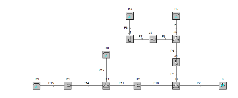

Thanks for your replies, as requested, I am attaching an image of the pipie network (drawing on a flow simulation software known as AFT FATHOM)
Hope this could help, Another question came across my mind while elaborating this simulation:
Could there be somekind of logigramme or a step-by-step method to minimize the number of iterations to be conducted in order to get the right flow in each pipe ?
I believe that someone must have thought of it !!
looking forward to receiving your replies

The 4 foam makers are J16 to J19?
Though I've not worked on fire fighting water supply networks before, would imagine a 5-10% variation in supply flow between J17 and J19 would be tolerable. So size the pipes such that this dp variation limit at max total flow is met? Adding an RO at J17 may also help if the line length from the supply tee to J17 to the supply for J19 is very long.

Start by assuming that the flow is equal to all your end points ( I assume J16 to J 19).
From J8 then work out the total pressure drop to each element. e.g. flow from J8 to J 10 is 50% of total.
Pressure are J10 is the same for both branches, but flow is 25% of total.
Do this for all branches.
Work out which one has the highest pressure drop then start to work backwards and then you will be able to see where you need to artificial pressure drop via your orifice plates.
e.g. from J 13 to J 19 (the highest pressure drop), your pressure drop is, say, 10 psi, but from J 13 to J 18 it is only 5. You know the flow, you know the pipe size, so then you can calculate an orifice size to add 5 psi to the J 13 to J 18 leg.
Do the same for the two main branches.

LittleInch, that's exacltly the problem, 4 foam makers are going to be working simultaniously according to the client because thare are feeding only one dike. After numerous simulation using the design concept you have introduced, I was able to regulate the flow with a small tolerence rate (3%), assuming the operating conditions are the same (pressure and flow rate) which I am sure that it won't be that perfect when running our system in real life.
RE: Orifice plate design
Good, glad it worked out. 3% in reality is not achievable - most of the simulations aren't that accurate, but it will get you a lot closer than not having any modifications.
