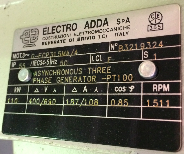

The whole picture: the motor is in reality a 110 kW asynchronous 3-phase generator (400 V, delta connected, 50 Hz), moved by an internal combustion engine. Because the generator is SO massive it tolls the engine starter way more than it's designed for and we keep burning it (not to mention constantly ruining the battery).
Our "brilliant" solution: use the generator as a motor (is it a brilliant solution???). Problem is there's no starter for this large "motor" on site.
The usual procedure to get this generating plant online is to start the engine, ramp the generator to sync speed and then connect it to mains. To avoid tripping the 250A protection on this line, there is a 3 phase inductance and a smaller contactor in parallel with the main one. First the inductance branch is closed (so we get the current peak "filtered" by the inductance) then the main contactor is closed. Finally we open the inductance branch.
Since this is an Asychronous machine, it is essentially a standard AC motor. If we had a delta-star or a soft starter we could use it to move the generator and start the engine... but we only have the inductances in place. Is there a way to use them to "soft start" the generator in motor mode?

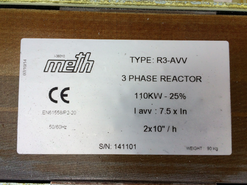

I had the idea to close the contact in the inductance branch with the engine and motor stopped: the inductance hummed and the motor moved about 1 degree. During the test, current in each phase was 210 A and the phase-to-phase voltage in the motor side of the inductance was 50 V... too little to make it spin.
What would happen if we close the main contactor while keeping closed the inductor branch? Will this make the motor run or trip the 250A protection?

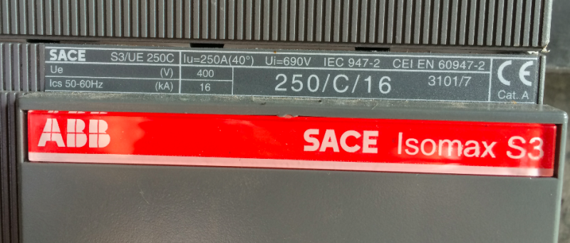

- the protection that trips is upstream of the meter (it's not user-accessible, cannot be bypassed). When we trip it, we have to call the utility maintenance guys so they reset it... HUGE hassle!

Why would a diesel power an induction generator? Can you post the nameplate details of the generator?

we have BEGGED the utility to change the protection with one having a longer reaction time curve. They just won't. Here's a photo of the plate of that protection:
Our original idea and the original switchgear was meant to connect the machine directly, but after weeks of asking the utility to change the protection we finally had to go with the inductance.

Some pics of the generator would be nice.
Some pics of the inductance would be nice.

That breaker shown will probably not support DOL starting.
How about a compromise?
If you cut out half the inductance, or replace the inductance with one of one half the inductive reactance you should get twice the current through the motor, from about 50 Amps to about 100 amps. That means 22 or four times the starting torque.
Now try the starter and energize the generator through the inductance both together. See if that will make enough difference to starting. If you need more torque than that, then reduce the inductance to 1/3 of the original value and try again. That should give you around 9 times the original torque.
The sizing of the inductor is a trade off between starting torque and connection surges.

Thanks for all your help, guys!
here is the info requested:
generator
generator plate
inductance

What I meant is that, given the protection in place, we have to be very careful on when we close the contactor. Even with the inductance in place, once connected at about 1515 rpm, tripping the protection.

If you are tripping that breaker when you close the main contactor we may ave to consider a sync check relay.

Well, we have never tripped again the protection since the inductance has been in place. The one time we tripped it happened because the governor was dirty and the engine surged to 1515 rpm exactly at the moment when the main breaker closed. If this machine has a 10kW/rpm slip, I believe the tripping happened because of the huge instantaneous power the generator tried to deliver.
The inductor will hold the generator in sync when the speed is close to synchronous speed.
The inductor will also be supplying magnetizing current.
At 1515 RPM the machine could be expected to be exporting about 150 kW.
However if the speed surge pulled the generator out of sync and the contactor closed against opposing back EMF then you can get the high transient currents.

I wouldn't count out wye-delta starting yet. You would basically start the generator in wye and then once the engine is started and you are running at 1500rpm you would transition the generator to delta with the reactor in the circuit. Then, short the reactor. Offhand, I don't know that breaker but the wye connection would reduce the current by the square root of 3 compared to trying it full-voltage. Why don't you first reconnect the generator in wye and give it a try by closing the main contactor to see if it would start?
We tried that in the early days and the motor indeed starts without tripping the protection.

Have you forgotten the suggestion to use an inductor with less inductive reactance? More torque and more current but not enough to trip your breaker. A compromise between what you have now and DOL starting.
OR
A decent battery.
Din't forget about those two at all. I'm asking the guys that manufactured that inductor if they can rewind it and/or make intermediate connectors, as well as a quote for a new one.
As for the decent battery, there are lots of brands available locally and they all have good reputations. Other than increasing the rating (we have gone from 125A to 140A in the last change, Friday) it's very difficult to make a "deterministic" improvement on the batt.

Further to Lionel's suggestion, if it works in wye, then it should work with a lower impedance inductor. Either way you have to increase the current through the generator above what the inductor will now allow. More current but less than DOL current.
The advantage of changing the inductor is two fold. You will not have wye:delta transition issues, and you may be able to use the existing contactors.

This is something we're working on: we asked again for a quote for new inductors or a modification of the one in place, they will likely respond shortly.

  1. voltage downstream of the inductor is 50V, current is 200A (mesasured friday, see above)
  2. knowing that the protection trips at 2.5 times nominal current and that it's a 250A switch
  3. we could -at least- increase current to twice the actual value ---> half the inductance we have now should provide twice the current and 4x the starting torque.

OK Now you have 50 Volts dropped across the motor and 350 Volts dropped across the inductor. A ratio of 1:7 Cutting the inductor in half will give an impedance ratio of 1:3.5. That would be a motor voltage of 89 Volts. Current ratio of 89V/50V or 1.78
That should give a torque increase of a little over 3:1
Hit the starter at the same time and it may work.

Just wanted to let you all know what the conclusion was: we decided to go with the lower inductance instead of the "delayed" D/Y starter, for simple economic reasons.
After discussing with the inductor manufacturer, he realized that the original one was oversized for the short period of time it works. After re-sizing, a new inductor with taps at about 66% and 50% the actual reactance has a price practical equal to that of a new starter motor, no particular hardware is needed and the labor to replace the existing one is the same as replacing the engine starter. Controls issues are minimal.
On the other hand, the cost of labour and hardware for a D/Y starter is 3 to 4 times the price for the engine starter.

In my opinion, if the locked rotor current will be 8*Irat at full voltage [400 V] at 65% will be 4*Irat. MCB of 250 A will trip at 970 A in not less than 5 sec.
The starting time for 65% of rated voltage could be less than 1 second.
You have to check the motor inertia moment [for generator rotor-could be around 2-3 kg.m^2 and for DG around of 20 kg.m^2 in my opinion] and the starting torque and maximum torque[Ts=1.7-2.2*Trated and Tb=2.4-2.6*Trated].
Then a series reactor of 0.085 ohm and 650 A for 8 second could be useful, in my opinion.
