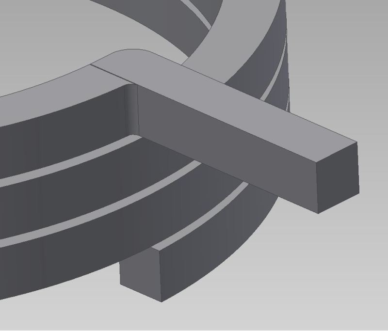

In your part file I see you're trying to make banded strip from coil end.
As the coils faces are not perpendicular to that strip, it is not available to connect them correctly.

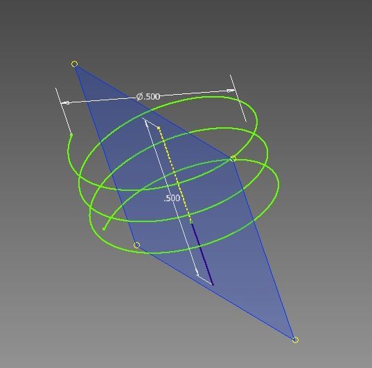

1. I tried to cut a small amount of rotation and draw two sketches. One for the Sweep Profile it is square end of the coil and another for the Sweep Pattern:

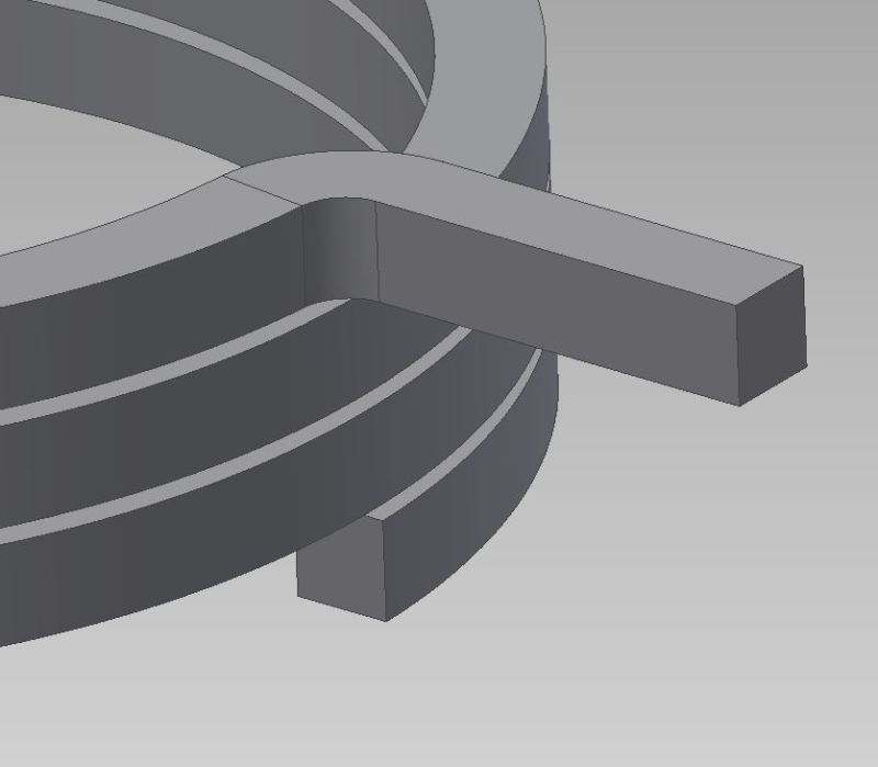

2. And here how it looks Sweeped:
Regards.

i used coil command. first in XY i drew a square, then coiled it. THEN in YZ, another square and extruded. LASTLY, fillet. there is a mis-match.
i can do your way, but, the tang needs to be on center, so, any off center cut will make the cross section not square but rectangular. a cut through the coil center, needs to do a calculation of the radius location.
i hope there is a way using 3D spiral line with two straight 3D lines, fillet first and sweep. but i could not line up the 3D spiral end with a plane.

It is not difficult to catch the right locations for the radius and center as Inventor gives some Projections and Constrains tools.
I am not sure will you able to open here I dropping back your file modified:
