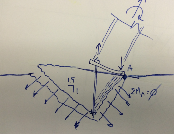

If it's a moment connection aren't you looking at roughly equal tension and compression force, or is there a lot of net uplift?
Plate on the anchor bolts is common for developing the anchors. Shear reinforcing would normally be vertical. Bent bars seem to make more sense but you don't see them often, presumably for constructability reasons. I think that aci 421 recommends additional reduction factor if using rebar instead of headed anchors for shear in mats.
RE: Anchorage into a mat slab foundation
It is moment, that's true. There was some net uplift, but it wasn't huge compared to the tension caused by the moment.
I'd always looked at the anchorage requirements on the tension side as being independent of the compression on the other side. Are you suggesting that the embedded plate connected to the anchors would inherently transfer the moment without requiring that we design tension anchorage? Essentially doing what KootK said, and simplifying this down to a punching shear calculation.
If so, that actually makes me feel a lot better. These anchorage calculations seem so complex these days (compared to when I did them 15+ years ago at my previous employer). Relating it back to a a different failure method (punching shear) that I feel much more comfortable with brings me closer to first principles and expected behavior.... Rather than trying to shoe-horn my situation into matching code equations that were derived for single anchors acting independently.
Quote (Book)
I agree with what I think you're getting at. If the anchors are long enough I think that you get a situation as shown in the sketch below where the lion's share of the tension is countered by the applied compression from the moment couple. The moment largely gets resisted by horizontal force mechanisms in the footing which makes sense as base plate moment must ultimately be converted into footing moment.

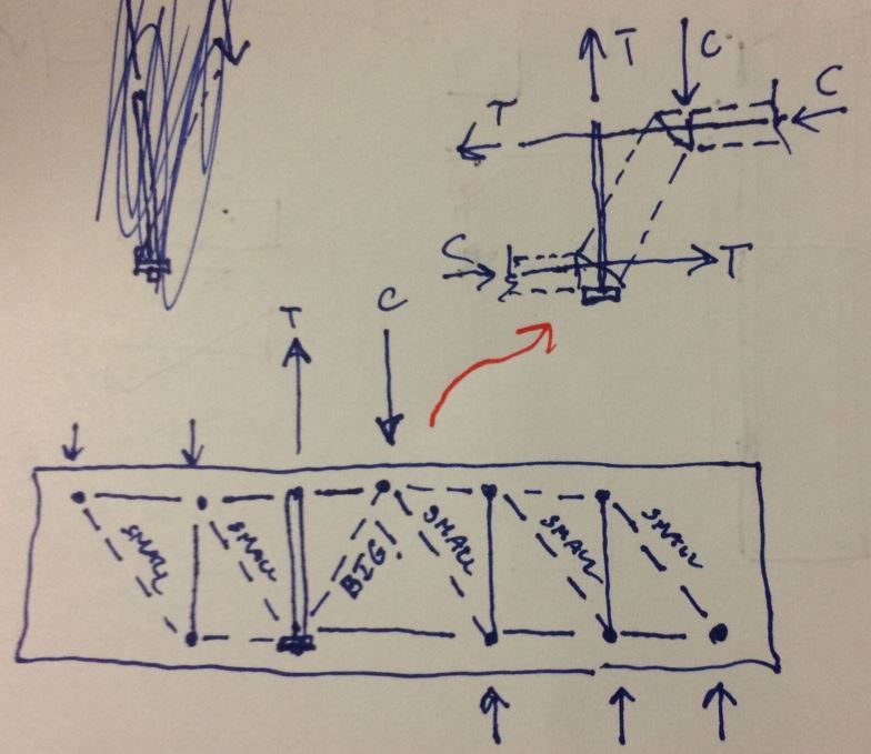

I've got 10 scratch scratch sheets on this just trying to get my head around it -
I think this arrangement makes more sense at the anchor head due to symmetry. I've also kept the theoretical ties orthogonal although I imagine the ties would be perpendicular to the splitting plane - a direction that makes the STM even more confusing. With this arrangement I can better visualize the moment compatibility through the depth of the footing (moment at the bottom of column = moment at the bottom of the anchorage.

@sandman: usually the objection that I get regarding embedding in a raft is difficulty in accurately setting and plumbing the columns. In that respect, a grade beam spanning over pad footings or piles seems to be much more palatable. How do you deal with this for the raft scenario?
@Teguci: I had to stare at your strut and tie model for a good twenty minutes before I fully grasped the subtlety of what you did there. It's brilliant. Creating a strut and tie model patterned after an Appendix D breakout failure really elucidates things. After mulling it over for a few days, I took the liberty of attempting to refine and improve your model. My thinking was as follows:
1) Your STM suggested a breakout frustum slightly different from the one that I proposed earlier. I adjusted the model to reflect my assumptions regarding the breakout frustum. I believe that it would be inherently asymmetrical about the tension anchor.
2) With #5 or smaller ties wrapped around longitudinal bars, I believe that it's fair to move your point "A" up to the top of the raft. This simplifies the model some.
3) I moved your point "C" up to the top of the raft and adjusted the last strut coming in from the right to hit that same point. This is consistent with my expectations regarding the compression stress trajectories in these areas.
4) I've got a compression field arching from the column/base plate compression zone all the way down to the bottom of the raft. Most of the compression would be absorbed into the tension anchor as the strut passes by.
Also, I finally figured out what you've been doing with that "v" shaped symbol that you draw over your ties that are represented by Vc. It represents SQRT(f'c), right? I'm adopting that from this point forward.
