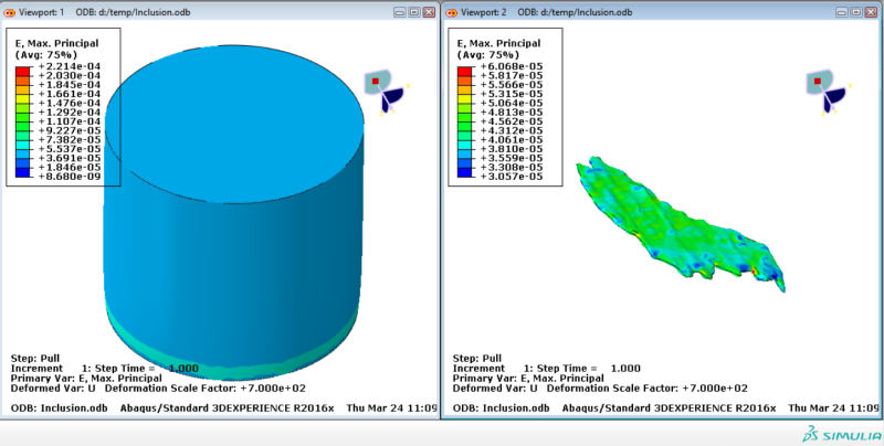

I have two different volumes, an inclusion and a cylindrical volume, which consist of two different materials. The inclusion should be insert in the cylindrical volume, that means the two parts should act as a single volume upon loading to analyse the stress concentration.
My idea was to define different materials / section assignments in the part modul and then use merge with retained boundaries to create one instance, so I can mesh the two volumes as one without using tie constraints.
However, preparing a data check, I get lots of warnings concerning tie constraints although I didn't define any constraints (see attachment with warnings; the 8783 nodes in the first line are the nodes along the retained boundaries).
The results were plausibel, but does this mean that I have to define tie constraints?! If so, what's the best way to create tie constraints - use cut in the assembly modul to create a "hole" with the shape of the inclusion in the cylinder and then insert the inclusion per merge?

Abaqus automatically creates the constraints, but I don't know when and why.
In my opinion the problem is, that I define the section / section assignment of the cylindrical volume using "region". This means the faces of the inclusion are involved in the section assignment and then, defining also a section assignment for the inclusion, there is an overlap. Is this possible and how could I avoid the overlap?!

I'm using Abaqus 2016 so I have uploaded the INP file instead. Here are the steps that I did.
1. Deleted merged solid and emptied the assembly.
2. Added both solids to the assembly.
3. Translated the inclusion 1 unit down.
4. Merged instances deleting the original and retaining the boundaries.
5. Tet meshed with default seeding.
6. Boundary condition 'FixBottom' only constrained in 1 direction changed to all 3
I hope this helps.
