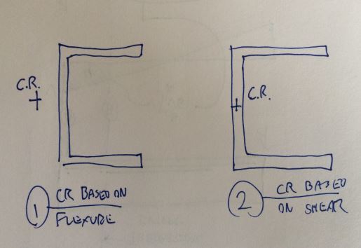

I'm dealing with a C-shaped building (at least that's the orientation of the shear walls - the fourth wall is essentially a curtain wall with pilasters that's assumed to not take any lateral load). In school I was taught that torsion is the bane of all C-shaped things, so I was leery when I realized there will be induced torsion due to lateral wind load, and in this case the basic wind speed is 133 mph.
My coworker assured me that he's dealt with a very similar circumstance and considered the side walls to act as a couple moment to deal with the torsion, however. See the attached sketch to illustrate what I'm talking about. (Sorry I didn't have a straight edge available KootK. I'll be better in the future.)
Some relevant info - 1 story structure, LFRS are int. reinf. 8" CMU, flexible roof diaphragm supported by bar joists, SDC A.
https://res.cloudinary.com/engineering-com/image/upload/v1458249956/tips/201603171603_udwxwf.pdf
edit #1: that should be vL^2/2B for the shear in the east/west walls.

It depends on the length of the cantilever and really depends on the diaphragm. For this case, I believe you would need to have a rigid diaphragm or use a semi-rigid diaphragm analysis. I have handled this similar to your coworker and it hasn't been an issue, as long as you make the right assumptions regarding diaphragm and detail the load to get to the right place.

I haven't seen warping considered for channel shaped buildings with shear walls. To me, the web and flanges that make up channels are more flexible and torsion on a channel member is different than for single story CMU wall buildings and torsion is not so much of an issue for the walls. I would go with the method you have shown unless the dimensions of the "flexible" diaphragm are too much for the cantilever action.

I'm not a believer in channel shaped lateral load resisting elements. I always like to provide a rigid frame across that open side. You need some structure across there anyway, so why not make the frame rigid?

This isn't your case, but this is no longer allowed in higher seismic zones. You might want to understand some of the failures that occurred in Northridge just to gain some perspective on the system. Might mean that you take a closer look at the deflections that occur for any gravity only columns along the open side of the building.

I believe nearly the opposite (I think). A cantilevered diaphragm is one of the few instances where you will get a rigid diaphragm shear wall load distribution regardless of the actual degree of diaphragm rigidity. It may be that we're actually saying the same thing here, just in different ways. I certainly agree that from a software modelling perspective, the diaphragm must be assigned some rigidity in order for things to pan out.
Quote (AV)
I agree with what you and your colleague have proposed. Essentially, you're treating the walls as individual linear elements rather than as a composite shape. And that actually makes pretty good theoretical sense. The flexibility of the shear wall system can be envisioned as having two discrete components.
1) A flexural component. See detail #1 below.
2) A shear component. See detail #2 below.
For a one story building of the proportions that you've shown, I would expect the shear component to do dominate by a significant margin. As such, treating the walls as individual elements is surely more accurate than treating them as a composite section.
