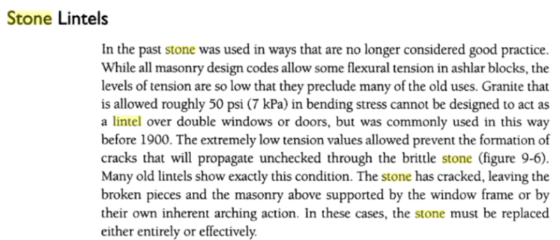

I have a client who wants to place an 18" thick x 6'-5" wide x 10 foot long stone over an entry way....like walking under an arch more or less. The stone is tucked under the roof for 80% of its area so a majority of the load is self weight. Are there any design guides to a situation like this?

Freeze-thaw - You should probably get a geotech to have a look. If this is a sedimentary rock, then I would be very skeptical of using it as a beam. Igneous would be a good choice (unless it has a high iron content). Metamorphic is probably OK as long as the strata will be mostly horizontal. For surface freeze-thaw, scaling will present itself if susceptible. For surfaces and seams, a coating system may be able to seal the stone from the water.
Brittle collapse - Either accept a brittle failure mode and allow for it with a higher safety factor (like what we do for compressive failure elements) or supplement the stone with Dywidag bars cored through the stone.
Factor of safety - if you want to refine the FoS to a real number, you will need multiple core samples to run a statistical analysis. With the analysis you can determine the standard deviation and then pick an FoS that will land you 3 (or 4) deviations above the average. In my mind, an 18" slab spanning 10 ft is probably going to be around a FoS of 8. I'm all for being overly conservative with one-off designs.

About a week ago I came across an existing stone lintel that had failed in shear, nice diagonal up from the bearing point all the way through. It was carrying a good amount of masonry load above so not the same as your situation. I wouldn't do it. You can hide some steel in there.

Took a picture of this stone cracked lintel for you. Carrying a lot more than it sounds like you plan on but maybe still informative. Hard to tell in photo but this is supported on a column below and that crack is to the bearing point, can't have more than 3/4" bearing left.

The structural design of natural-stone lintels is not included within the British or British European Standards and it is therefore impossible to provide structural design calculations to confirm the adequacy or otherwise of a natural-stone lintel for a particular situation. For this reason it is normal practice for a stone lintel to be supported by a galvanised steel, reinforced or prestressed concrete inner lintel or beam. Figures 21 and 23 illustrate some typical examples.
While the adequacy of a natural-stone lintel cannot be confirmed by calculation, such lintels have performed satisfactorily for many centuries and may still have a role in this respect. As a general rule, provided there are no defects in the stone, a stone lintel should be able to support normal wall loads up to a span of 1.5 m without the need for a supporting inner lintel. When the bonded nature of a masonry wall is considered, the actual load on a lintel up to this span is quite moderate and well within the load-bearing capabilities of natural stone.
