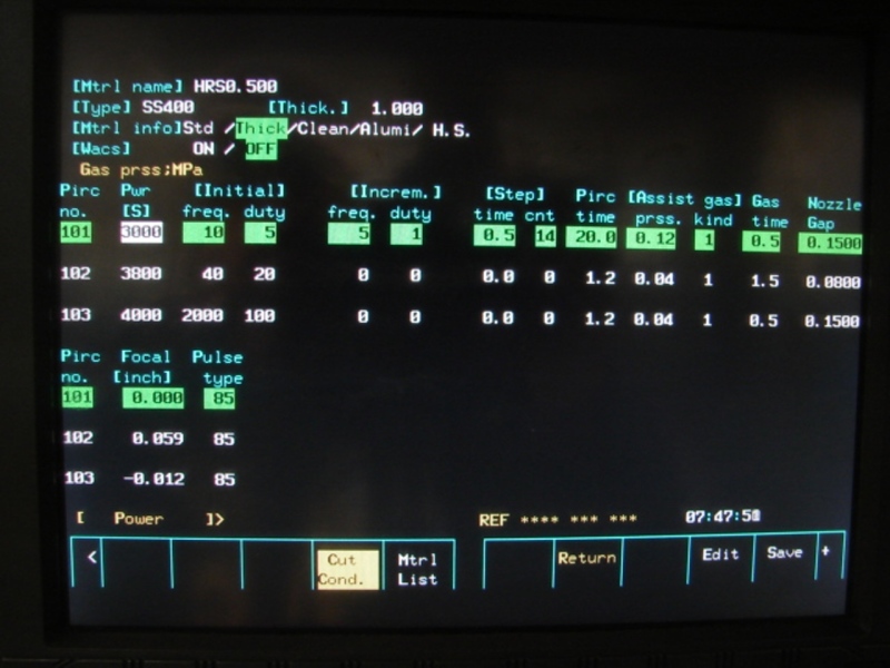

Well I used the settings that you guys are using. It has made my cut 10 times better and I am loving it already. Thank you very much. Now here is the issue and I will add in a picture as well. But my pierce data may be no good as well because that is the only area that isn't cutting well. What kind of insight could you shed on this problem? Thank you all in advance.

If you use a M103 pierce this would be a ramp pierce, you can control some issues, this is the 101 pierce line in my picture. But I would try fix it with my edge and approach data first because if you don't use the proper conditions after the leadin line your cut will get away from you. I set up all my edge data conditions on 203 and all my approach on 201. I use 201 because the first line you cut is the leadin so it's easy to remember. I use the some conditions for all my mild steel tables but I will increase the distance the thicker I go. I hope this helps, sorry so long but to explain edge and approach data takes time.

Your cut conditions should work if all you use is E3 and E4. I program with E3,E4,E5,E6 and E7 for all materials because we have some tight tolerance holes or larger holes where the E3 is too slow. I would mess with focus at this point, try -.079 and see what it looks like. If it looks better go deeper until you start to lose the cut than back it off some. If the cut looks worse go up until you see a good cut.

This is it I had to do it on my own so use this site the people are great at what they do. I would copy my edge data from 1/4 but change the distance to .08 and the pierce power to 4000. At this point it's just a good focus and clean optics as long as you conditions stay put and you have a 1.4 dbl flow nozzle and a 7.5 lens.

Approach and edge data is real easy so don't over think it. Approach data is use on the lead in line so after the pierce the approach data kicks in. It will use the same power from your cut condition but will change the duty and frequency to what you put in under recover. So look at the picture on 1/4 I posted, the 201 condition will use a frequency of 10, a duty of 30, federate of 3.94ipm at a distance of .03 when that is finished it will go back to your cut condition and finish the lead in. Now the edge data is exactly as it sounds it is used on the edge of your cut weather it's an inside cut like a hole or an outside cut. If you have a tight corner with edge data on it will cut to the corner and stop, call up the edge data conditions and run them just like it did for the approach data. In this case the 203 line I use for edge data is the same as the 201 line I use for approach. Now the work angle is what determines if the data will be used. So if any two line without a radius make an angle smaller than your work angle the data should kick in.
