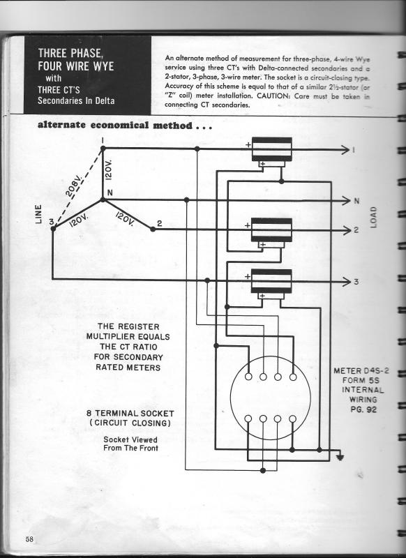

For support I cite the delta metering connection to meter three phase power with a two element meter.
"A" phase CT is connected to one current element in the meter.
"B" phase CT is connected to the other current element in the meter.
The CTs are connected in an open delta. Generally the "V" point is grounded for safety.
The third, "C" CT is connected across the open delta, forming a closed delta.
The current developed by the "C" CT travels through both the metering elements of the meter. Each element meters a component of the "C" phase current.
The accuracy of this scheme depends on the three phase voltages being equal as the "C" phase current components are metered against both the "A" phase voltage and the "B" phase voltage.
The point of this anecdote is that the out of phase CTs choke off the "C" phase current so that all of The "C" phase CT secondary current is forced to pass through the meter elements rather than through the other CTs.
My metering handbook assures me that this scheme gives good accuracy with balanced voltages. That would not be the case if any significant portion of the "C" phase CT current was passing through the "A" & "B" CTs rather than through the metering elements.
The two meter elements in series provide a low impedance path for the "C" phase CT current so that high voltages are not produced.

Here are some scans from my old metering handbook.
The current in line 2 is metered by the elements for line 1 and line 3. The impedance of the CT secondaries is so high, relative to the impedance of the metering elements that not enough of the current from the line 2 CT is diverted through the other CTs to affect the metering accuracy.

RE: CT Misconnection
waross,
The metering diagram is slightly different to davidbeach's issue.
The metering circuit doesn't have secondary windings in series, even though it sort of looks like it. What goes into the two meter elements in essentially the vector sum of B-A and C-B, so this doesn't put any of the 3 windings in series.
Ausphil
The point is that all of the current goes into the meter elements. Virtually no current is forced back through the other CTs. Either one of Davids CTs may not be able to pass much current through the other CT.
