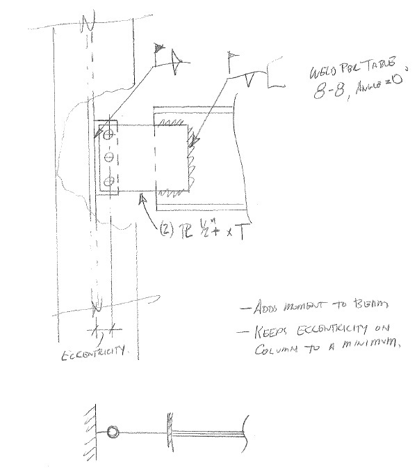

We have to provide a standard shear connection for a beam to an existing fireproofed column. The middle of the beam to the edge of fireproofing is approximately 12 inches. I assume they will have to chip out the concrete on the column in order to weld the shear plate to the existing column. The disconnect is, the length of the shear plate that connects to column and the shear plate of the beam.

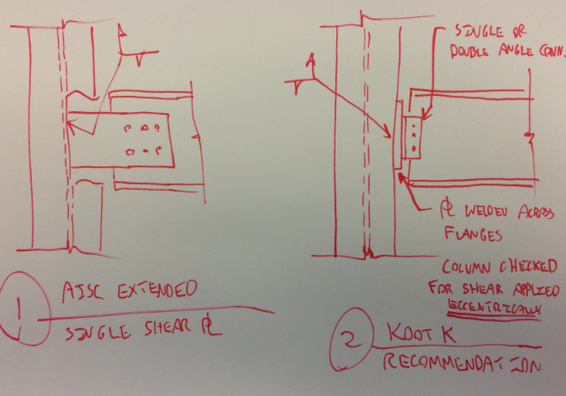

I've proposed a couple of options below that I hope you'll find helpful:
1) AISC's extended single shear plate connection. You can find some design information here: Link
2) A method of my own invention that I think would be preferable because it would require less concrete removal. The downside is that you may need to check the column for the moment arising from the eccentricity of the shear connection.
