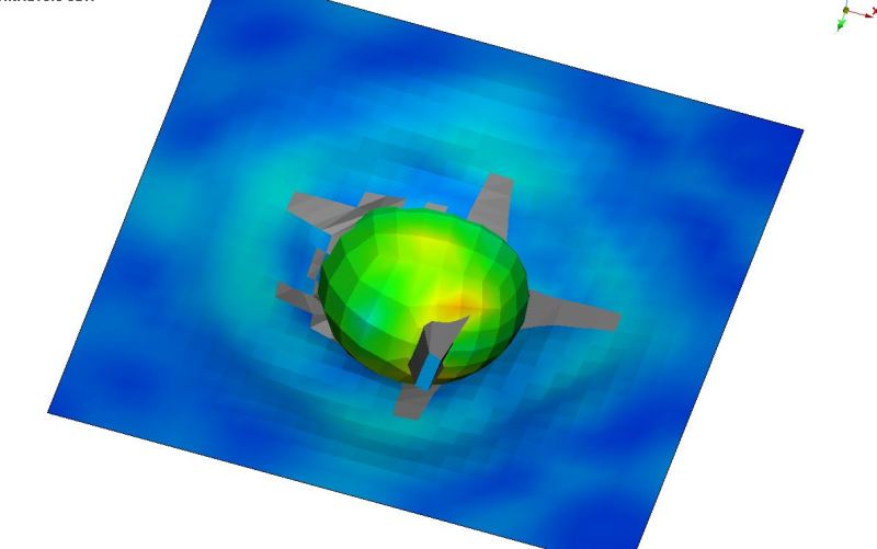

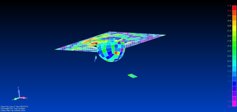

I tried many to times to run an Explicit analysis, but I think Femap doesn 't behave as it should, or better, as other Explicit solvers do. Like LS-Dyna or Abaqus.
I tried to do something like this http://www.dynaexamples.com/intro-by-j.-reid/symtu... (select the animated result to see it better).
The LS-Dyna material of the tube is the well-known MAT_024 Piecewise Linear Plasticity. I made a stress-strain curve according to the example, also considering the "rupture" element flag in SOL 701 and the corresponding fail strain.
The problem is that when the elements fail, there are HUGE strains and displacements. The elements should not appear anymore, as with all Explicit solvers. I cannot understand why Femap present fail elements like this. It 's very annoying.
You can also see it on other models...
Can anyone give me a help on this problem?

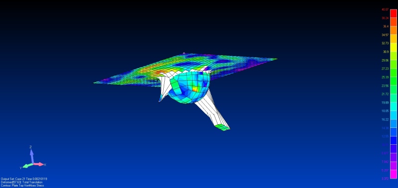

Also, in this video https://www.youtube.com/watch?v=hhqigu_PHCk, the same happens, but the user did the "trick" with the black backround and the black elements color and the problem is not well appearing.
Also, in the 3rd video here https://iberisa.wordpress.com/2011/12/05/analisis-..., you can see the strange white elements beside the bullet. By the way, the 4th video where it seems right, it seems that something 's going wrong with the Femap interface...that "TIME" up-left, definitely is not a femap feature. Maybe it 's not with NxNastran...

I'm not an expert but the wired element shape from secend picture in your post happened to me before. Usually the reason was too coarse mesh. With smaller elements it was fixed. Have you tried this already?

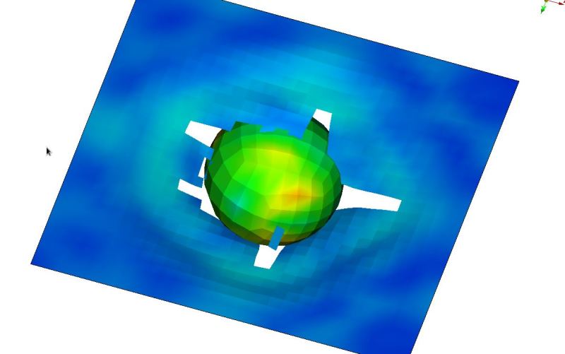

The problem is that Femap does not have the opportunity for not showing the failed elements.
Below you can see the above file with the ball and plate, reading from another post-processor, not Femap.
In the first picture you can see the failed elements as it came from Femap, with grey color.
In the next picture the failed elements are not shown and the model is pretty nice!!

I think you should take a look at View Options - Criteria Levels and "Elements that pass" vs "Elements that fail". Femap does have the functionality for not showing failed elements. I have used it but it was a while back so I don't remember directly how I did it.

I only made it with criteria style. I set up right the criteria levels for pass and fail and it works fine. The failed elements are not showed. But in contour style the problem remains....
RE: SOL 701 - Problematic Behaviour of Ruptured Elements
Hi again
Well it has nothing to do with Criteria Levels, like you say, but instead it is Criteria Limits that should be used. I kney it was something with the criteria settings.
So Femap can do it, in Criteria Style mode.
