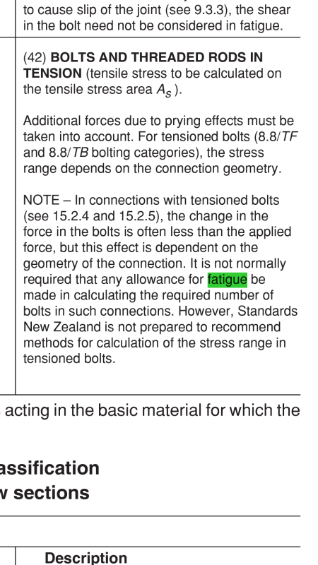

For comparison in NZS3404:1997 it was 36 (1997 version of the NZS3404 standard is virtually identical to AS4100 apart from additional seismic requirements), in the NZS3404.1:2009 replacement of the fatigue section they removed the bolts from the fatigue section altogether but I was never sure why. Could be due to the difference of opinion you have noted?
They also had this warning in the 1997 version which maybe why they removed it?
