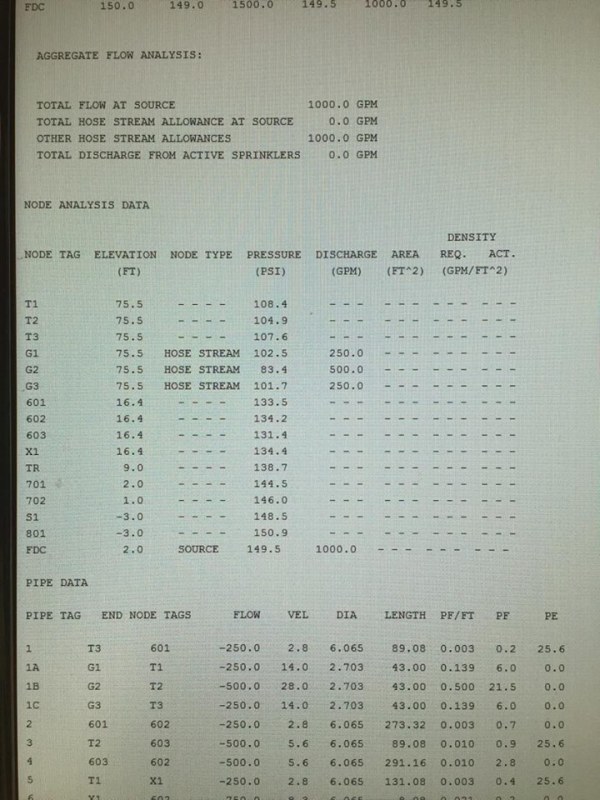

How do I account the pressure loss for the hose valve?
From table 8.3.1.3 NFPA 14
I figure the equivalent length should be 31+12=43 ft (hose+tee)
So where do i add this length in the hass program ?
RE: pressure loss for the hose valve
Just make a node HV1 for the hose valve. Make a node O1 for outlet 1 on the standpipe. Then just enter the piping between HV1 and O1.
You can call these nodes whatever you like. This is just a very simple understanding of the program that you need in order to operate the program. It has been 15 years since I used HASS.
Heck, you could manually figure the friction loss from the valve to the outlet on the standpipe, then use that point as as your start... It's about 9.3 psi for 250 gpm to flow through 43' of 2½" sch 40. So, just use your outlet on the standpipe and start with 250 gpm @ 109.3 psi.
Good luck!!
43' of 2½" , 500gpm
The pressure loss is 21.5?
The pressure for the 500gpm hose is dropped to 83.4 (node g2)
I can't get the system work even if i change to a 10" standpipe.
What did i do wrong here?
Read NFPA 14 again. You do not flow 500 gpm through a single 2½" nipple. You flow 250 gpm at the top two outlets. As such, you may have two hose valves at the top of the remote standpipe to facilitate testing. So, your loss is only about the 9 psi that I mentioned above.
7.10.1.1.1 For Class I and Class III systems, the minimum flow rate for the hydraulically most remote standpipe shall be 500 gpm (1893 L/min), through the two most remote 21∕2 in.
(65 mm) outlets,
and the calculation procedure shall be in accordance with 7.10.1.2.
I see people confuse this stuff all the time. If you go by the text, you will find it works out a lot better.
