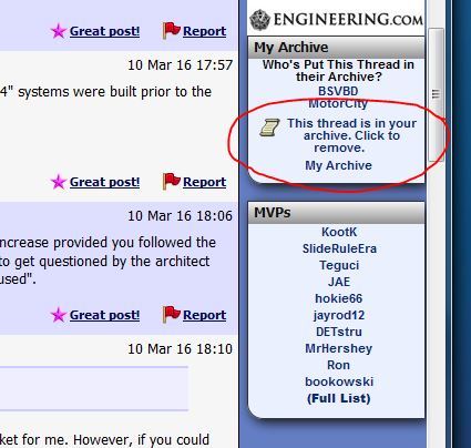

How do I archive this thread? Thank you!
EIT
RE: Handrail Posts
Look near the scroll bar on the right.
I already archived this, as you can see, but, you will find it in the same area.
RE: Handrail Posts
