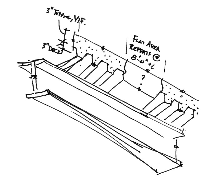

We need to anchor our system into this soffit, but I've never seen a profile like this before. We have a 3" deep steel decking system with a flat area that repeats every 8 ft or so. I think its a cellular system for running electric, but its fire proofed so we can't identify the edges. Has anyone seen a system like this installed before?
RE: Unfamiliar Steel Decking Profile
I like your cellular deck theory. Would need more data to identify the specific product.
