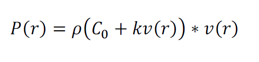

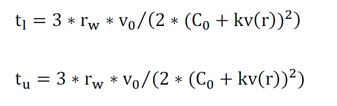

Hello, i'm trying to model the impact of a water droplet on a solid with abaqus. my loading time as well as my pressure are variables they depends on R (the position of the droplets in the R axis)
How i can enter a variable loading time?
Thank you.ponytails2
RE: variable step time and pressure
Time variation can be done with an Amplitude or a user subroutine.
Spatial variation can be defined with an Analytical Field or a user subroutine.
But the options without subroutine require, that you know in advance where and when what loading has to be applied.
