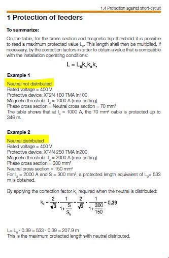

Good afternoon,
Can anyone explain me the defirence between a 3phase system with neutral not distributed and with neutral distributed.
Always made big confucion on that.
tx

RE: Neutral distributed / Neutral no
hi,
I am sizing a cable that comes from a 3ph distribution board to distribution board lets call him Board 1 that will feed 3phase and 1 phase loads.
In order i can make some calculations i need to know the Iminshortcircuit.
Please take a look at the example, that i attach, and tell me please what is the meaning of neutral distributed and neutral not distributed.
Tx for the support
Please take a look at the 2 screenshots
I don't think that we have been answering the question that you have been asking. Sorry.
I am wondering:
In the case of multiple parallel conductors does this refer to an installation with multiple conductors per phase with one neutral conductor as opposed to an installation with parallel neutral conductors, one conductor included in each group of three phase conductors.
It is hard to grasp the context.
Possibly someone familiar with those calculations may be able to help.
It seems that example #1 is using a 100A breaker and a full size neutral.
Example #2 is using a 200A breaker and a 50% neutral.
