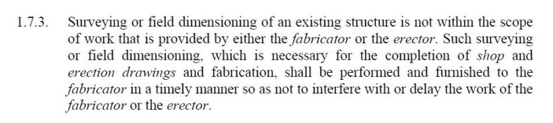

First - section 1.7.3:
This states that the fabricator and erector don't have the responsibility but it lies with others - possibly either the contractor/owner/engineer.

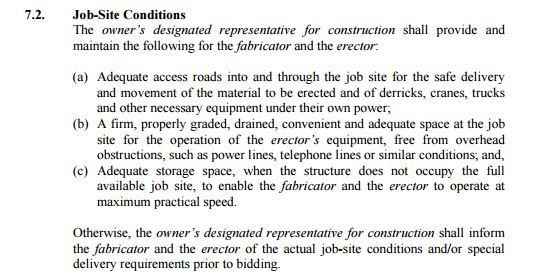

Second - Section 7.2:
Section (b) of this states that the general contractor needs to ensure no "overhead obstructions".
RE: Relying on Survey - Standard of Care

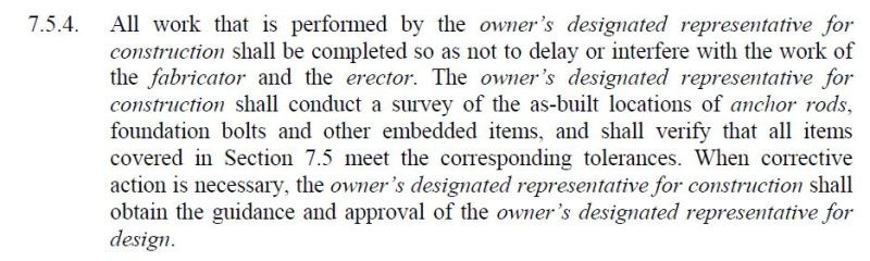

There was also this section (7.5.4) which talks about surveying existing anchor rods, etc. which is to be done by the contractor.
This at least suggests that field condition verification is really the responsibility of the GC. I looked through the newer 2016 version (yet to be published) and it is similar:
