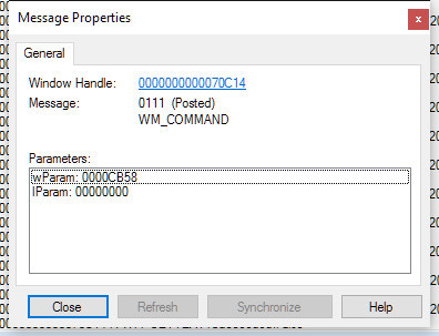

RE: Open "Part in Position" using API
Thanks, may I ask what tool you used to find the parameters?
I am using Spy++ and this is the code that I am getting for "Open in Position" command:
<006733> 0000000000070C14 P WM_COMMAND wNotifyCode:0 (sent from a menu) wID:52056
when I select property, it shows this windows:
From the code I can get the OPEN_IN_POSITION_CMD=52056, but I don't know what is WM_COMMAND. I tried 111, but it only highlights the whole part.
Please let me know.
WM_COMMAND is a message which is sent with the parameter 52056, WM_COMMAND = 273. If you convert 0111 from HEX to Decimal you will get 273
