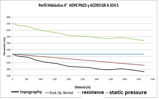

I need some help to design an eventual system, that has 300 m of static pressure, alot.
the pipe is steel, but the pressure at the first moment, can be dangerous for the operator, so I wanna know from experience, what can I do to reduce the static pressure, the moment when I open the valve?. (Orifice Plate or Pressure reducing Valve only work when the system works in a continuous way)

Sorry for the poor information, i didnt want to complicate the question with many variables.
its suppose to be a system to clean chute of transfer in the mining, so I need high pressure , but the end of the pipe should be connected with a hose, so the operator can clean the chute.
This is the hydraulic profile for a 4" pipe, where at the top is connected with a Tank.
As you can see the blue line represent the static pressure when the system is not being used.
So how can I control this huge pressure? sure can I slowly open a valve, that will represent a instant energy loss, but it will be dangerous for the operator.

Your first post says 300m of static - you are now saying 3000+ m - what is it?
RE: Reduce static Pressure
Artisi - read the graph - It's elevation. He's going from 3,300m (quite a long way up) to 3000m.
If you size your control valve right then it shouldn't be a big issue.
You might need a plug and cage type valve to handle the pressure. Either that or a pressure regulating valve located upstream of the last valve which shuts off tight at say 5 bar and controls the downstream pressure to 5 bar. 5 bar is enough to create a serious jet.
These pressure might seem huge to you, but in reality are low to medium pressures for a lot of other applications.

I think LttleInch is right. Your best bet is a Pressure Regulating Valve which will control downstream pressure ~5-7 barg. I wouldn't go higher than that. Some of local plumbing codes limit potable water pressure to 5.5 barg because of safety reasons.
300 m of water column is 1000 ft head = 422 psig = 29 barg. I wouldn't want to be a person opening a valve in the end of this line!
