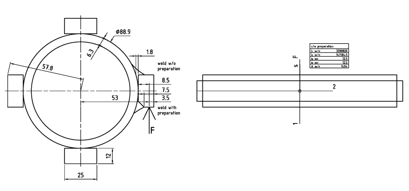

What we are doing is actually something like a micro pile.
there is a driver on top which have the force transfer via that 4 little plate which is welded onto the pipe.
At the field, we were told that the 4 plate that welded onto the pipe actually shear off.
So, now it's back to the drawing board so that we could know
1) the force that the little plate could hold before shearing.
2) if the welding could hold such force.
What's the issue with me is that i did not came from Mechanical background, so i am still stuck after going through the net about shearing.
Your assist on this issue is much appreciated.

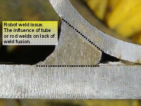

RE: shearing of material
Can you post some pictures of the "sheared off" plates and pipe?
For instance, showing clearly if the "shearing" goes through the weld, the plate, or the pipe.
Also, some pictures of the preparation of the plates before being welded, the fit up between the plates and pipes, and several of the finish welded plate/pipe assemblies.
As asked by others, details about the size and type of weld are needed.
When welding the plates to the pipe, is fixturing used to assure the consistent position and alignment of the plates? What is the tolerance on plate positioning, and the drive lugs of the coupling.
I'm guessing it is likely that only a portion of each plate is in contact with the drive coupling
Is the pipe rotated during the weld process, so each plate's welds are made in the horizontal position? Or, are some welds made out of position ( vertical or overhead).
Also, please provide pictures of the driving coupling, to see how it engages the welded plates, yet still misses the welds.
How thick is the pipe wall?
How do you inspect the finished welds? Is any non-destructive testing done of each finished weld?
Are multiple passes used on each edge of the plate?
Have your welders made representative test coupons and submitted them for some destructive testing?
6013 is generally considered a "fast freeze" electrode with moderate "penetration", often recommended for sheet metal work. There may be other electrodes better suited to making secure welds on these thick parts subjected to heavy loading.
Hello SH,
From your input:
At M=20 kNm, if divided by 4*56 kN, you assumed the acting radius to be equal to the dia. of the pipe. But you need to relate the radius to the application point of the force onto the plates, so F imo should be 20/(4*0.053)=94,3 kN.
If welded w/o preparation the plate would have an important gap to the pipe, this should be avoided --> Assumed weld preparation as drawn, a weld to be 4.5 mm. Shear for one plate would arrive at approx. 63 N/mm². Assuming applicability for your utilization of standard FEM 2.132 (conveying machinery), the permitted statical shear stress at fillet welds for common / main loads is approx. 275/235*113 = 132 N/mm². Concluding: At least 2 of the 4 plates need to be load bearing.
Imo bending action should not be neglected, to the effect of a von-Mises stress of approx. 129 N/mm², to the same effect as said above.
Yes, you could have a stronger pipe than that, but with thicker walls + thicker welds, the loadbearing capac. of the fillet weld shall decrease too. Limit: t. b. sought / t. b. clarified.
However, if your load is rather cyclic / alternating, fatigue strength limits would apply, these being drastically lower than those mentioned above.
Now, as desertfox & Tmoose point out, there's little probability that with a welded design the plates shall arrive at an equal distribution of forces.
@ Tmoose: Thanks for these pictures! --> *
@ OP: Could you pls. give us some pictures of the failed item? How are you proceeding? Thank you in advance for sharing these data!
