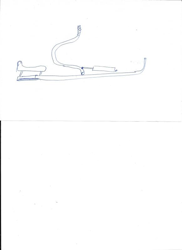

RE: Kayak Propulsion.
This is interesting. It looks like a good arrangement to make good use of arm and upper body strength.
BUT
As it is it would leave the person much too high in a kayak. That said, the pivot points are not that low, and it is the placement or location of the pivot points that determines the characteristics of the machine.
A thought; Instead of the work arms going down from the pivot, how about riding Between the persons legs and then curving out to both sides to end up in the same position for the handholds?
The hydraulic shock absorber could be swapped for a cylinder to extract energy. The cylinder would be mounted towards the front instead of towards the back.
I'm thinking that the mechanism, that is the seat, the seat rails and the handle bars may be able to be inserted into a conventional kayak without structural modifications. It would depend on the size of the cockpit.
But the other problem remains; how to efficiently get the energy transposed into forward motion.
To get serious energy out you'll be moving your C of G a lot. If you add in a moving seat to get max leg input it only gets worse. Your idea about putting the actuators between your legs is mimicking an ergo rowing machine
So I return you to my first point in my first post.

The method of harvesting energy shown in your animation is interesting. The flywheel and recoil device may possibly be mounted on the fore deck of a kayak. Thanks.
I agree with the advantages of arm and leg movement for maximum power, but my kayak and many others do not have room in the cockpit for leg movement.
We have two design areas yet to explore in depth;
Transmitting energy to the propulsion device, and the propulsion device itself.
TheTick's comments may be foreshadowing some challenging efficiency issues.
Quote (TheTick)
Out there among the dopey-dippers and swishy-flailers is a siren moving twice as fast with half the effort.
Most of the problems with human-powered propulsion are human. Good paddling takes proper technique. It also requires sensitivity and awareness of one's interaction with the water. Most casual paddlers exercise neither.
And
I find this is what separates the good paddlers from the dippers and flailers. The good paddlers are constantly aware of the feedback of their paddle. They waste less energy on splashing or other pointless motion.
Perhaps there is room to innovate on this front. Paddles that better transmit feedback? Propulsion systems that respond to and minimize inefficiencies?
Bill
