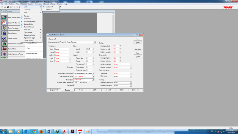

Greetings from Peru I currently have problems in the simulation with trace 700 which is detailed below : when income area in square feet at the stage of creation of the room and made the calculation to display the report these areas are amplified x10000 do not understand because this error I am simulating in trace 700 version 6.2.4 and also is simulated in trace 700 6.3.2.2.s and is the same problem I would be very grateful for the assistance it can give me

Looks like you have 1000 duplicate rooms for each space. Look in your rooms tab and change the rooms per zone to 1. If you have 1000 rooms per zone then you will get the square foot area multiplied by 1000 as part of your calculations.
RE: Greetings from Peru I currently hav
I think Ziggy is right. Click on the "Rooms" tab to change this value.

the changes that I mentioned I have already made but this error persists also I reinstalled the software but still persists this problems

I don't know why it would make a difference, but have you tried using the actual room dimensions rather than the total sqft and 1?

What is mentioned before, did you change integer values in pc settings? you should try to change it at control panel, try option with u.s. setup as language and numbering setting.
try your local setting, than u.s. setting and note whether there is any difference in the output.
