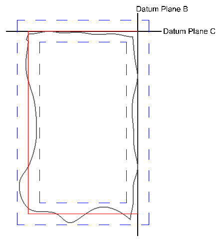

Hi All,
I expected some disagreement regarding the centerplane datums for the basic widths.
pylfrm - I agree that 4.11.4 does not specifically mention features of size. But it makes no mention of a basic size either. In the figures that show a dimension for a width datum feature, the dimension is always directly toleranced. I was not able to find an example that uses a basic width (or a basic diameter, for a cylindrical datum feature).
CH - There are some figures in section 4 on width datum features, that only show a datum feature symbol and a dimension line (no dimension is shown). Does this mean that this is a legitimate way of specifying a datum feature? I would say no, because these figures are intentionally incomplete.
Tenkan - I agree that the placement of the datum feature symbol and dimension line makes a difference with width datum features of size. But because basic dimensions were used, I would argue that the 4.9 and 8.2 widths are not features of size. The definition of a regular feature of size in 1.3.32.2 contains the statement "associated with a directly toleranced dimension". I would say that a basic width controlled by a profile tolerance is not a directly toleranced dimension - you (and others) may disagree.
So at the end of the day, Y14.5 does not give a clear indication of whether or not a basic width results in a centerplane datum. It makes no indication that you can do this, but doesn't say that you can't. So we have to decide whether this is a valid extension of principle. Overall, I would say that it is not.

Evan,
You may want to take a look at fig. 4-33. This figure does not seem to support your standpoint.
Besides, if we really want to analyze the paragraphs in the standard, para. 3.3.2(b) states that datum is a center plane if the datum feature symbol is placed on the dimension line or an extension of the dimension line of a feature of size. It does not say 'regular feature of size'. The widths in question are features of size, just not regular, but irregular, as defined in para. 1.3.32.2(a).
J-P,
On your first picture the maximum possible offset between both surfaces can be 1. On the second picture only 0.5, because half of the tolerance zone width is unsable as it lies inside the material of datum feature A-B simulator, and the datum A-B is established by the high points of surfaces A and B simultenously.
This concept has not been explicitly pictured and described in the Y14.5-2009, but most likely will be covered in the future version of the Y14.5. From existing standards the closest is fig. 4-16 from Y14.8-2009. It shows datum target application, but the basic tenet is the same - profile tolerance zone applied to datum features from which datum plane is derived is equally disposed about that datum plane. This means that in case of datum targets the entire profile tolerance zone is usable, but in case of datum feature being entire surface only half of the profile tolerance zone is usable.
3DDave,
With that being said, in the OP example there would be a difference between having and not having datum feature reference B and C in the profile callout. Since only half of the profile tolerance zones are usable for each pair of opposed surfaces when B and C are referenced, the maximum allowed angular error between surfaces in each pair (expressed in linear units) is twice as small as in case of profile callout with no datum references or reference to A only. I am not saying that presence of B and C makes sense from functional point of view, just trying to describe difference.
Hope this helps.

pmarc - why would only half be available? There are some difficulties with making a feature's location tolerance self-referential, but I don't see half. The references locate the midplanes that are the origin of the tolerance zone so they cannot influence the size of the tolerance zone. Since the zone is unaffected, the orientation limits are unaffected.
What I think it would do is reject a certain number of parts that are as usable as parts that are accepted.

JP,
I don't perceive any difference in interpretation between your first picture and your second.
John Acosta, GDTP Senior Level
Manufacturing Engineering Tech
RE: GD&T question
pmarc,
Okay, you got me on this one. You're absolutely right, I hadn't thought of irregular features of size at all. Basic widths and profile are used with those, the examples clearly show it. I'm not a big fan of the irregular features of size section - I don't think the definitions are very clear. Perhaps this is why I didn't think of it - it never entered my mind to apply the "irregular" concept to a feature that has "regular" geometry (two opposed parallel planes). This does not seem very intuitive to me at all, and must be very confusing to those who don't obsess over the Y14.5 standard like we do.
But I would disagree with the interpretation of the zone availability. If B and C are treated as features of size with centerplane datums, then I would say that the entire zone thickness is available for the B and C surfaces. Like this:
So the form of the B and C surfaces, and maximum angular error between them, is the same as it would be if only A was referenced (or no datum features).
I would agree that specifying the B and C datum features does make a difference. Aligning the profile zone to the two B surfaces will be different than best-fitting it to the four surfaces together. This will need a different figure though.

J-P and All,
Here is how I would envision the situation for the coplanar surfaces:
I've shown the same as-produced surface geometry for both cases. When no datum feature is referenced, the surfaces can occupy any part of the zones and the control is equivalent to coplanarity. When the A-B datum feature is referenced, the surfaces must have high-point contact on simulators located at the basic surfaces.
I believe that this is fully consistent with pmarc's description.

Evan, if you made the profile unequal you could have anywhere from no tolerance to all the designated tolerance.
RE: GD&T question
It's actually even more interesting, because it depends on the process you use to establish the datum.
If you use hard gage to establish "highest points" datum, then only half of the tolerance is usable on the datum features.
If you "average" your CMM measurements, the entire tolerance is available.

pylfrm,
That's a good question. I would think that the general tolerance would apply to everything, and then other tolerances would be refinements that would apply in addition to it.
powerhound,
It sounds like there is still a difference in our points of view. I'm saying that the tolerance zone is centered about the true profile in both cases. I don't see the zone extending from the high points inwards in either case. Please see the additional example below. Here is the logic:
1. The tolerance zones have basic location (centered about the true profile).
2a. If no datum feature is referenced, the toleranced features can be simultaneously fitted (rotated and translated) relative to the zones to get the best result.
2b. If datum features are referenced, the datum feature surfaces must contact the datum feature simulators at their high points. The datum feature simulators are coincident with the true profile.

Yes, if the profile tolerance was SPF|1(U)0|A-B| then there would be no usable tolerance. Interesting.
CH,
You're correct, but the method used to establish the datum is not open to interpretation. The default is high-point contact with a perfect simulator. If an averaged plane (such as least squares) is used, then the rules are not being followed. This is a big issue with CMM's.
greenimi,
I believe that you're correct. If the B and C datum features are width features with centerplane datums, then the entire profile tolerance is available for the B and C surfaces. If the B and C datum features are each single planar surfaces, then only half the profile tolerance is available for the B and C surfaces. Strange, isn't it?
Here's another example:

pmarc,
Yes, good catch. I think I got my material direction turned around because it's the bottom surface. The number after the (U) is the amount in the direction that adds material, and the datum plane sits on the high points of the surface. So you are given a tolerance for how much material is higher than the high points ;^). Odd, isn't it?

The other side discussion was about a case where the datums are taken from those two surfaces only. (To designate that you'd have to move the datum symbols to be offset from the width and height dims.) If that were the case then you'd get only half of the 0.1 on those two surfaces, but the full 0.1 on the other two sides.

This is why I suggested to the committee they use something like +.010/-.005 to indicate material added and removed about the nominal profile, but someone had already committed to (U) and that decision was -done- and could never be revisited.
RE: GD&T question
axym,
Your reply to greenimi...
Quote (I believe that you're correct. If the B and C datum features are width features with centerplane datums, then the entire profile tolerance is available for the B and C surfaces. If the B and C datum features are each single planar surfaces, then only half the profile tolerance is available for the B and C surfaces. Strange, isn't it?)
Why would you say that the full tolerance is useable on all identified profile controlled surfaces with the datum center planes, when those dattum center planes are established by contact on "both" surfaces for each datum center plane ?
Wouldnt all identified profile controlled surfaces be contacted to establish the B|C datum center planes which would give half useable tolerance zones for all 4 surfaces?
RE: GD&T question
dtmbiz,
It's true that all of the profile-controlled surfaces would be contacted to establish the B|C centerplanes. But the "halving" effect only occurs when one individual plane is used to establish a datum. See the figures from my Mar 4 and Mar 6 posts.
The halving is not any kind of rule or condition that's being imposed - it's a consequence the "self-referencing" feature control frame. If the toleranced feature also establishes a datum plane, and the tolerance zone must be centered on the datum plane, then half of the tolerance zone is below the feature's high points (and therefore usable) and the other half is above the high points (and therefore not usable). In other words, the high points of the surface are perfect (coincident with the true profile). This doesn't occur when the datum feature is two opposed planar surfaces, because the high points of the two surfaces are not necessarily coincident with the true profile. This is very hard to explain in words - the pictures do a much better job.
The moral of the story is that in Y14.5 datum features are not all treated equally, with the same amount of tolerance. There are the halves and the halve-nots ;^).
