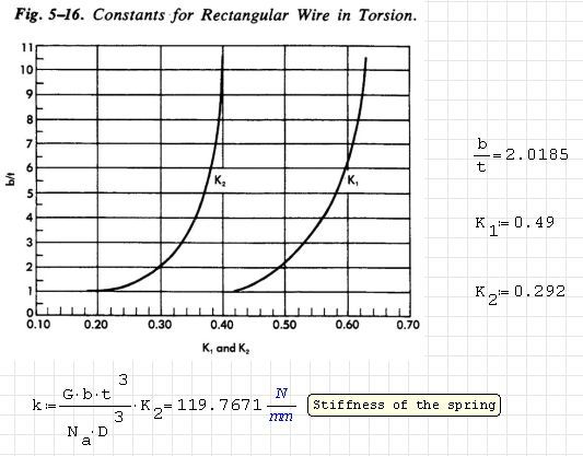

Thank you so much, that was a great help
while using it, I faced a problem , for the compression helical spring with rectangular section, when I calculate it myself, it give a very higher result regarding to ISO 10243,
there for a green spring of diameter 50, I have the stiffness of 156 N/mm
while I use the formulas i have the external diam = 49mm (should be in fact a bit less than 50), b=5.4, t= 10.9 , n = 6 , free length = 64 mm, Dm = 38.1, k2 = .4 ( with respect to the b*t)
I get the spring constant K = 674.6 N/mm
I just followed the formulations, but I get a very different result

Hi LCform
Right I have a copy of ISO 10243 and all I can see is different spring rates, rod and hole sizes for tooling to compress a spring, which is what ISO 10243 is about:- tooling for compressing springs of rectangular wire.
Further the only reference I can see relating to the 156N/mm stiffness you mention is on page 6 and it states the hole diameter for the spring housing would be 50mm and a rod size of 25 mm and a free length of 64mm but it does not dictate the number of turns, wire section etc, it is up to you to design the spring the ISO is merely quoting a spring which falls into a rate of 156N/mm, with a 50mm housing bore plus a free length.
Now if you study the formula on the Roymech site the dimension 'b' should be the maximum dimension of the material which in your case is 10.9 and t = 5.4, so in the formula I think you have these reversed and in doing so you end up cubing the 10.9 dimension instead of the 5.4 dimension.
If I swop the figures round I get a spring rate of 120N/mm which is much closer to the 156 N/mm you're looking for.
If I do the calculation with t = 10.9 I end up with a spring rate similar to the 674 figure you mentioned.
Incidentally I get K2 to be 0.292 and not 0.4

We use a full stop here for our decimal points. However even at 56.3 N/mm for the stiffness I still don't agree and what I've found is that the 'D' used in the calculation should be 38.1mm the mean diameter and not the 49mm O.D.
If I run the calculation:-
k= G*b*t^3*k2/(Na*D^3) = 78.3*10^3*5.4^3*10.9*.292/(6*38.1^3)= 118.25N/mm using the 38.1 mean diameter.
k= G*b*t^3*k2/(Na*D^3) = 78.3*10^3*5.4^3*10.9*.292/(6*49^3)= 55.59N/mm using the 49 outside diameter.
The diagrams in the pdf show D/2 as the mean radius, therefore D should be the mean diameter evidently and not the outside diameter which as been used in your calculation.
Note the 118N/mm stiffness is very close to my figure of 120N/mm

@desertfox : your attention helped me solve the problem and confusion , great thanks a lot
@Viktor : Special thanks for the software, the best thing for mathematical reports , thanks a lot , also for the help
Best regards
RE: Helical springs with circular and rectangular section
desertfox, indeed, I was mistaken and you are right, D should be the mean diameter. Thank you.
