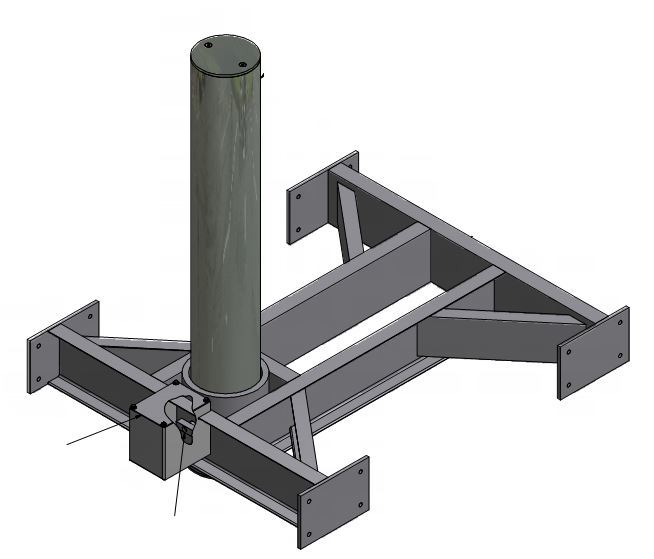

There're two types of bollards :
A)non-security bollards which is not intended to to stop the vehicle but to give warning as described by jayrod12 , Those types of bollards are usually designed considering impact force of
26.7kn (passenger vehicles) as per IBC 2012 - 1607.8.3 .
B)Rated Security Bollards are designed to immobilize the vehicle while the bollard is still functioning after the impact which require a footing with massive dimensions and depth (Like 3.0m x 3.0m) for stability. The design of those bollards shall follow BSI PAS68 specifications.
Security bollards with its foundations are special ,designed/produced by specialized certified suppliers and shall be used only where specified in the project (Not everywhere).

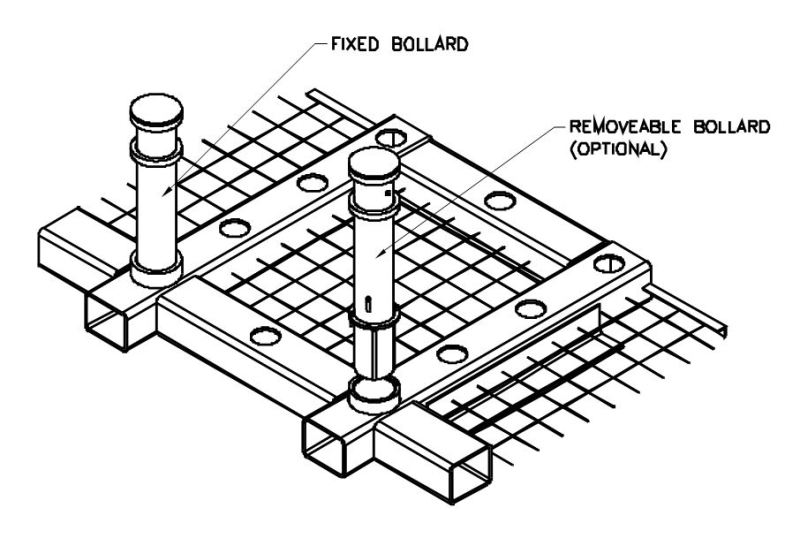

SOL82 - agree with you - but there may be also a third type that is a warning - but only psychological....lots of shallow footing bollards (concrete filled pipes with 18" dia. conc. piers only 3-4 feet deep) that would "warn" someone visually to be careful and would "warn" someone if they hit them at slow speed.
We've done physical bollard projects where we used proprietary bollard designs that have been tested - they require special designs, testing, rebar, etc.:
RE: gatepost, flagpost, or bollard footing
Please note that in that last detail a "continuous" concrete footing is shown. From a quick glance or for people not familiar with steel reinforcing notation it might be mistaken assumed to be a drilled post hole type footing.
