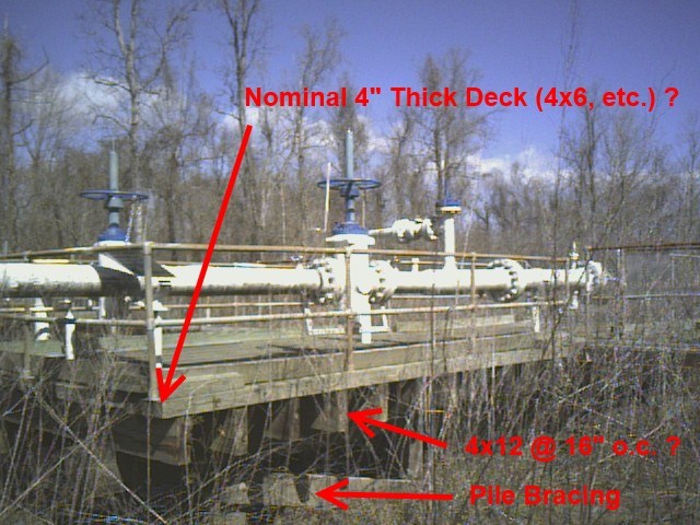

This platform will be in swamp area. Should I use PT wood to prevent wood decay?
I have ZERO wood design experience.
This is very simple on the structural analysis point of view and I can easily do that.
I'm looking for guidance for the size and type wood column, beam and floor and the connection that would be "practical/common" to use in this case. I can size the wood thru analysis but what size should I start.

delagina - The platform in the photos is designed for heavy industrial use... see the marked up photo for the clues:
Note the closely spaced, heavy stringers.
Decking that appears to be a nominal 4" thick.
Pile bracing.
Get the geotech working on this project first thing. The piles are likely friction (not end bearing) with significant embedment length in the poor soils often present in swampy areas. Based on the apparent size of the decking, stringers, and probable long length, nominal 8" piles are probably undersized.
Establish a realistic live load rating, if the client can't provide one, reverse engineer the existing platform superstructure (that won't be hard) to come up with one. IMHO, it probably in the 150 lb/ft2 (or higher) class (no live load reduction).
Simpson does not offer hardware suitable for this type construction. Plan on heavy bolted connections.
I agree with boo1 on the 2.5 pcf CCA treatment and hot dip galvanized fasteners. If creosote is used, specify 12 pcf retention.

I think the loadings here are very minimal. This is just a simple maintenance platform.
I think the existing wood platform (picture) was overdesigned.

Delagina:
You are kinda asking all the wrong people, all the wrong questions, at this stage of the game. I agree with a number of the earlier posts, this is not a light framing deck, this is an industrial working deck and should be designed and built accordingly. You should most certainly be talking with your client’s pipeline engineering dept. people about the lateral and vert. concentrated loads on the deck, and then also apply something like 100lbs./sq.ft. as a uniform deck loading. There will be pipe supports resting on your framing system, you can see several of them in your photos. I can easily imagine a 20' piece of pipe with several valves on it laying on the deck waiting to replace an existing like pipe section. There might be a couple small portable lifting devices (tripod legs?) standing on the deck for this change-out. They have to explain to you how they will use this deck and the loads they impose on it.
You should most likely use treated timbers to frame this deck. Ask some real industrial lumber suppliers in that area what’s available, species, grades, sizes, lengths, etc., not the local big-box store what they have in stock. Simpson or Mitec, etc. might have some usable framing hardware, but likely not. Again, it is an industrial installation, not light framing; so, while the NDS is a good guide and starting point, along with some good wood design text books, this is timber framing. You use most of the NDS methods for design, but you must use the tables for large sized members, not the 2x - 4x tables. AITC and some large timber suppliers have some good literature on timber framing. Remember that when you stack layers of framing like you photos show, you should block btwn. floor beams (fl. jsts.?) and consider proper bracing systems in all planes and directions or you are kinda building a house-of-cards, layer by layer. Even though you are using treated materials, there are some great peal-n-stick water protection products on the market now. They are applied to the tops of all members, except the deck planks, they are self healing when spikes, screws, bolts penetrate them and they shed the water off the member tops. Available lengths are much more a function of how long a piece of a large timber can be cut out of a tree these days, than are transportation length limits. Longer lengths and larger sizes bring a premium price, and the size vs. transport and lifting might much more be governed by what they can haul several miles through a swamp, and lift at the site. What type of equipment do they use for this haulage and for lifting materials out in the swamp? There should be some soils info. available from when the pipeline was being designed and then also when being built, which would be helpful. They have to inform you on these types of issues, and this in turn will inform your design. They must have some std. details for this type of work, or some plans, by others, from earlier installations. Getting large equipment out there to drive piles could be a real dog. You might take a look at some of the screw-pile/foundation systems and see if they wouldn’t work in place of long wooden piles. One of the things you have to check on their account is that the soil conditions do not cause corrosion problems with the embedded portions of the screw piles. The pile loads should not be that great, and those screw type systems are pretty easy to install with fairly small all-terrain equipment.
