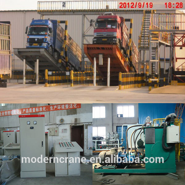

I was just answering the post. As others have said, the main aim is to park these on level firm ground then lift in a controlled manner. See this as an example of what should be done.
https://www.ecta.com/resources/Documents/Best%20Pr...
You could build something like this - this is the only picture I've seen where by some sort of structure is involved.
The point is that when you lift the body of the truck, that is where the weight is so anchoring the rest will just twist the body if the truck isn't level or starts to tip. Fix the root cause first. Some more details of what and why you've been given this task would be illuminating.
