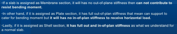

As Jason said, membrane has no out-of-plane stiffness unlike plate; hence simply make the bending resistance to Zero. If your structure is plane, set analysis to 2D to ignore other deformations. Below is for your future reference.
