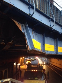

This is a recent collision from a superstructure replacement project I'm finishing up. Very low clearance & trucks aren't allowed on the road but it's still been getting hit on average 15 to 20 times a year for as long as anyone can remember.

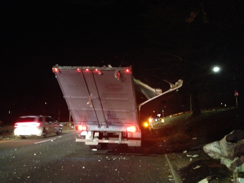

A local railway bridge got hit a few years ago by one of those garbage trucks which have a front set of arms to lift industrial sized bins over the roof. Due to the speed of the truck the arms hit the substantial steel structure to prevent such things, went under that and wedged itself under the bridge, blew out the tyres(!) and they took all night to cut the thing to pieces to get it out.

The truck -or rather, what's left of it - that hit the bridge I cite.
