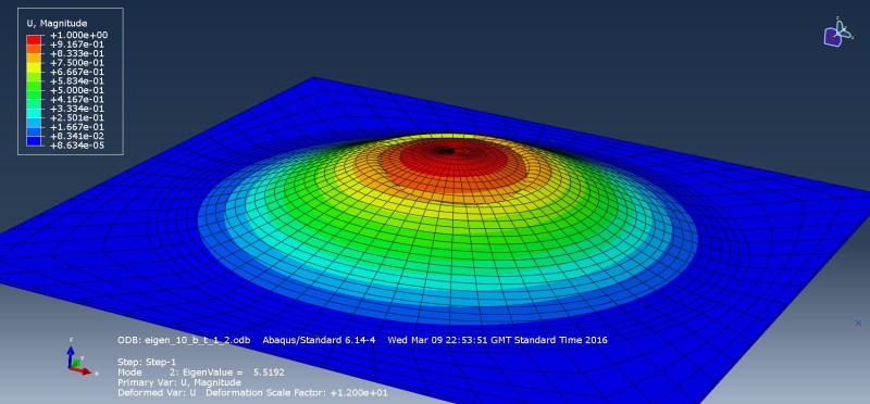

What I meant with my question is the following:
Here is a picture after *BUCKLE analysis has been executed and one the second buckling mode is this one.
I hope you can clearly see how the top element layer intersects the bottom element layer as a result of buckling. Clearly this is impossible to happen in reality.

The region of this intersection is a circle with 30mm diameter. In the region between the circumference of this 30mm circle and the circle with the longest circumference, there are connector BEAM rigid elements between the first element layer and the second element layer. -> This is the reason why we do not observe any intersection there. The connector rigid elements force the two layers to move together when buckling happens, but as I said only in this region.
However, my problem is this strange unrealistic intersection in the 30mm circle.

RE: Modelling Delamination Buckling of Damaged Composite Materials
So the contact status cannot change and the deformation is just a scaled representation of the eigenmode.
