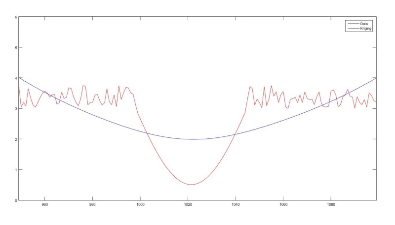

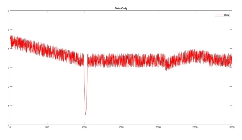

Right now, we've selected "kridging" for smoothing. I have some code that runs, though I'm not entirely sure it's doing what I really want. The data for testing code is fake, but one important anomaly is mimicked in the fake data: a sharp spike at about the 1000 sample mark lasting about 45 samples (see picture).
(y-data included as attachment...if anyone would like to plug it into code and run)
The question is...if you're running in data at real-time (almost) and want to ignore this or similar anomalies via computational and statistical methods, how should I go about doing this to maintain the trend from the first chunk of data, then continue on with smaller chunks of data being added. I have seen some other examples, but unfortunately nothing like this in MatLab that I can interpret. Here's the code I'm working with (thanks to developer of KrigingP.m):

Here's an example output plot:
Later, this will be used to mathematically match a function to the trend and plug-in a prediction point some number of samples ahead (say maybe 20-50). Which is why it's important to travel across the anomaly with little influence to the trend.

Most data processing approaches have some scheme for rejecting obviously bad data. However, your simulated data does not simulate a spike, since it consists of multiple data points that are locally monotonic, which is more like aberrant behavior than a spike. Is it really a spike? It has no noise, i.e., it's much smoother than the actual data. So, is the smooth behavior inherent in the anomalous data?

@IRstuff Ah, yes...so, that's a good point. That "spike" when I generated that fake data didn't include the noise the other data did, though I'm not sure it would make much of a difference when running it through the trend. So, to answer your question, the smoothness of the spike is not necessarily part of the anomaly, though the real situation may yield that there would be less noise during that short time period anyway.
Also, as far as the rejecting of bad data, I would really like to just bundle that type of rejection into the forming of my trend, but that's the tricky part. Technically that anomaly would be acceptable data and the trend should be more influenced by it, if the anomaly type of shape occurred for a longer time period. I hope you see what I mean.

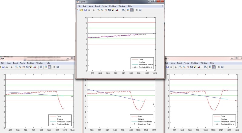

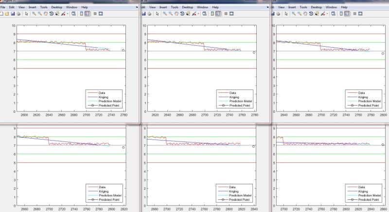

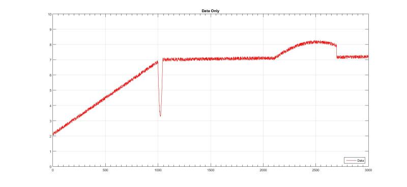

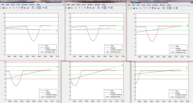

I've been playing around with different methods, and I am starting to realize for the prediction, maybe I really want a linear fit because that type of anomaly if rejected simply makes the data fit to a nice line. I may still want to store the smoothed result for evaluating other trends in the data, but will be for later. Any thoughts on those more talented in the way of fitting or statistics? I imagine the knowledgeable would tell me I can do many methods, the very knowledgeable would tell me which ones I don't need to use. That's what I'm getting at here...what can I get away with my trying to jump from trended data to prediction? (this may sound "unsafe" to a lot of data-analysts, but for what I'm doing, it's just fine)
see pictures for results using linear methods (including predictions this time):
Also, note my sensor choice has changed (more resolution and higher range... 0-10 now), ignore colored horizontal lines (means little in way of the problem).
Description for first picture: All the data shown (with 2 anomalies a relatively abrupt disturbance at samples 1000-1050 and ~2200-2700 a relatively subtle disturbance)
Description for second picture: Some figures plotted of the data around first anomaly, linear trend method in dark blue (sorry, labelled incorrectly as kriging here), and predictions (part 1):
Description for third picture: Some figures plotted of the data around first anomaly, linear trend method in dark blue (sorry, labelled incorrectly as kriging here), and predictions (part 2):
Description for fourth figure: Some figures plotted of the data around second anomaly, linear trend method in dark blue (sorry, labelled incorrectly as kriging here), and predictions (part 2):
Any thoughts on the matter, still would be appreciated.

There is nothing you ca do to "tweak" simple algorithms against problems such as this. One thing that you could potentially play with, assuming timing allows, which you didn't specifically answer, is to apply a 100+ sample median filter. This will still produce some humps, but greatly reduced. However, these humps are dependent on the anomalous data being sufficiently short in duration.

Thanks for your input, I really appreciate it, but I'm not sure I really agree. For example, I was using a function polyfit in MatLab before, and I did indeed just tweak my code by using a first order parameter into the polyfit (which is really just a linear model) and my prediction error improved.
That is the type of tweaking I'm speaking of...also, someone else may have other clever methods of resolving some of these types of issues and would love to learn from anyone else if they have some experience/insight into the matter.
