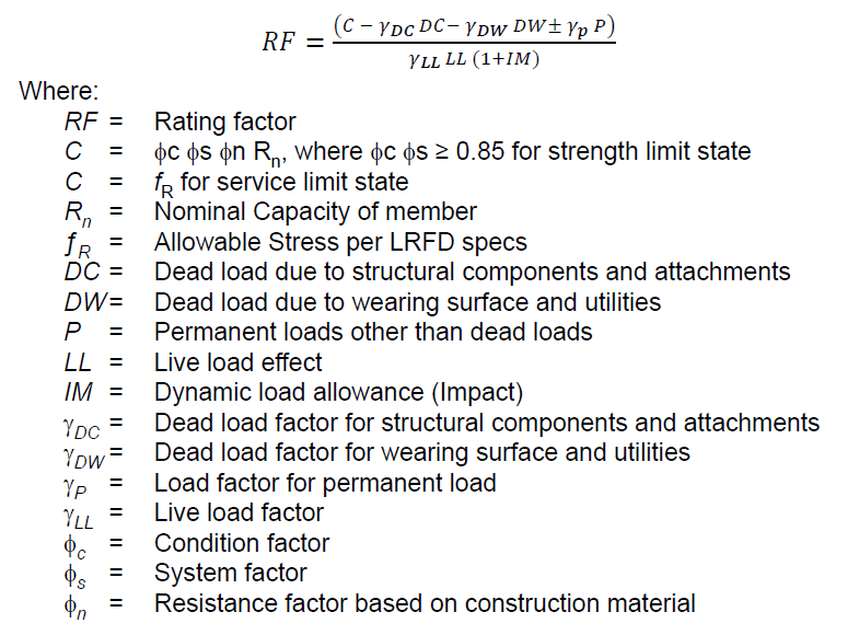

I gained valuable insights from 'manual bridge evaluation'. In the uploaded file, I have shown an example of rating from 'bridge engineering handbook'. As highlighted, the nominal moment and shear resistance were computed based on steel rebars ( and of course effective depth, neutral axis and etc.). What if there's limited info on this aspect in bridge design drawings and reinforcement details are not available?

RE: Strength Capacity of Existing Bridge
If we're talking about a concrete beam and there isn't any design information available, you could/should field measure everything, take cores to determine the design strength of the concrete & use a pachometer or hand held GPR to approximate the reinforcement in the beam.
The AASHTO manual also gives values for concrete and rebar strengths based upon the year of construction. Another thing would be to look at plans for similar bridges if available - some old text books have details and spec requirements - and make an educated guess.

For getting in-service properties, field test is planned for near future. I did look for similar bridge plans; the point is all of the available examples (even in AASHTO manual) only bridge with nice and clear drawings are illustrated to get the As, neutral axes (NA) and you name it; no one talked about hand-drawings of old bridges with respect to estimating nominal member strength. So even reading the hand-drawings detailing is quite cumbersome. I'm planning to ask some bridge engineers regarding this aspect, since it's out of academic scope.
Sure, there's no easy way to teach someone to read old as-builts. Sometimes, you can find ways to read and reasonably interpret the drawings. Sometimes, the drawings are too illegible or just not available, and you'll be forced to the field measurement bridgebuster mentioned. Or sometimes, you'll be able to read enough from the drawings and apply some engineering judgement, experience, and maybe a few field verifications to conclude that the illegible details match a detail shown elsewhere that you can read.
I'm in bridge demolition, so this is a hazard of every job we encounter. Oddly enough, it seems the drawings from the 30s are often preserved better than drawings of bridges built in the 50s.
