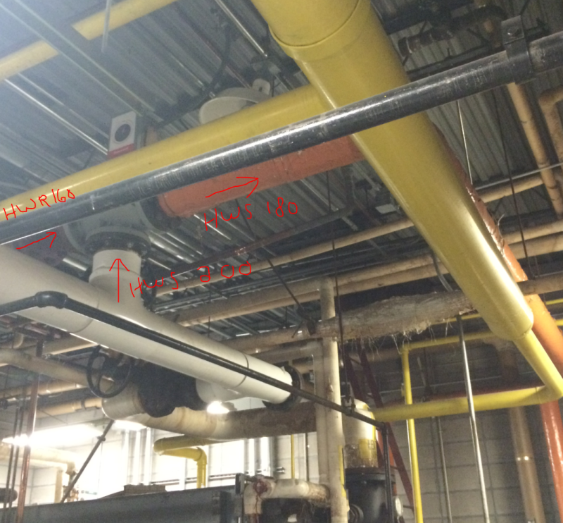

Gents,
I have come across a boiler piping arrangements last week where I can only identify one set of pumps, and what seems to be a primary secondary system decoupled by a 3-way valve. I'm used to seeing this arrangement with two separate sets of pumps, one set of the primary loop, and one set of the secondary. The latest work was done in the 70's. I am tasked with removing these older boilers, and replacing with low mass condensing boilers. Does anyone have experience with this type of piping arrangement? Thanks.
Picture attached
RE: Non-condensing Boiler Pumping with 3-way Valve
I realise you know what you're looking at in that maze of pipes, but how on earth does anyone else??
A diagram would be a lot better.

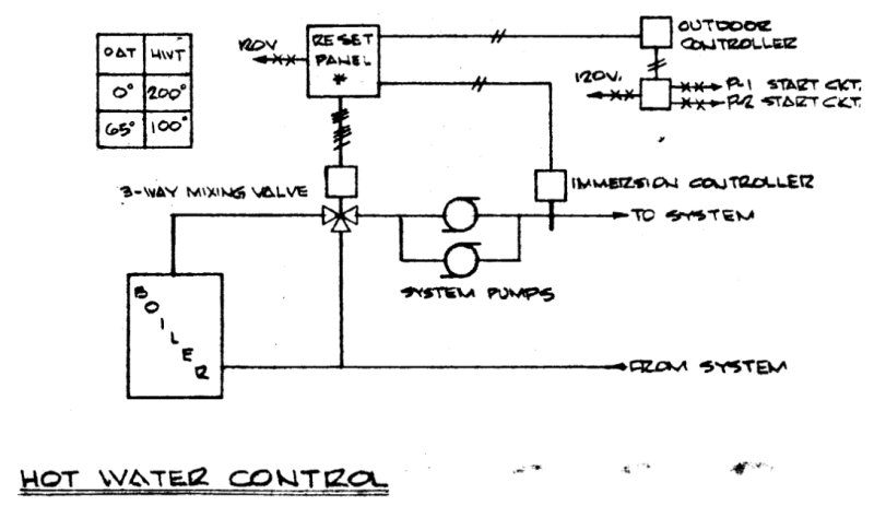

It's a Honeywell actuator. I found this diagram on their website, and I think it describes what's going on here.
I'm aware of the relationship between return temp and condensing boiler efficiency. I just want to make sure I understand the system as it currently stands. I've only seen primary secondary in older boiler systems, not this three-way arrangement.

Found this among the original documents:
Per this schematic it looks just like a bypass mixing situation. If the boiler is sized for a 20 delta T and the return is 40 lower, then this is needed. It also is needed for non-condensing boilers to keep from condensing.
I've seen many copper finned tube boilers on much smaller applications need this.
