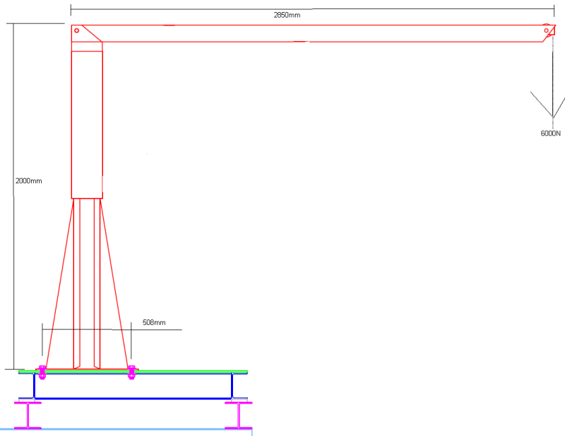

Hi there
I'm currently trying to find a equation/formula to help show the applied for acting on a bolt and making sure its within the yield strength of the bolt.
From the image you have a davit with a load on the end, this will then transfers the force onto the bolts.
Currently i have used the shear formula and tensile to get the individual loading as followed
e.g.
Load : 6000N
Bolt : 10mm
Yield : 400MPa
Shear (single shear)
tress = Load / A..............A = 3.14 x 5^2 = 78.5398mm^2............6000 / 78.5389 = 76.3943N/mm^2 (MPa))
As there are 4 bolts holding it down then i devied the stress by the number of bolts for get the individual stress on each bolt..............76.3943 / 4 = 19.233575 MPa
400 / 19.233575 = 20.79 factor of safety (FoS)
Tensile (same formula as single shear)
Stress = Load / A..............A = 3.14 x 5^2 = 78.5398mm^2............6000 / 78.5389 = 76.3943N/mm^2 (MPa)
400 / 19.233575 = 20.79 (FoS)
As the forces is not acting on the axis or in a shear formation but at 45Deg, do i need to have the force applied in each direct at 50%?
Also in not sure how to combine there's to get the overall stress on the bolt.
Im also aware that the load will course the davit to rotate in some wear between the base and end of the davit arm
If anyone can point me in the right direction it would be appreciated

You show the load being applied at the davit arm, this creates a moment. You can decouple this moment to figure out the forces on your bolts. Some of your bolts will be in compression and some will be in tension. All four of your bolts will not be in tension so your tensile stress divided by four bolts is not correct.
Also where does your shear come from? You show an arrow showing a "force on bolt" which would put bolts in shear and tension. Where does this come from? Is this an external force? Because you do not get shear from your diagram from the 6000N load on the davit. You need to be clear on the Free body diagram.
Lastly, AISC has a check for combined shear and tensions. Doesn't sound like AISC governs in your area though.

andriver thanks for you reply.
I was trying to get a simple formula without going over the top with out having to do moment calculation, yes i know it not the bet way to do things.
due to not doing a moment, i estimated that the force would act towards the point of loading on the arm to make things simple.
if it helps the arm is 2.8m long and with the point being 2m high.
With this im going to two of the bolts in tension which are the ones at the back? for the one at the front will be in compression but not directly as the plate will have the load and ill be pushing against the base so with that are these not negligible and can be left out or do they need a different formula?

The davit will have a moment from a whatever it is lifting. This moment is equal to your load*distance from center of davit column to location of applied load. You can get the tension in your bolts by dividing this moment by the distance between your bolts. The tension can be divided by the two bolts that are in tension.
No where in your diagram do you show shear, you could probably get some shear from wind or a swinging load from the davit.

Ill try this for the equation:
Ill do the moment of the force:
Mast weight : 1745N
Boom weight : 863N
Load weight : 6000N
Bolt patten : 508mm square
Bolt : 15.6mm
Yeild : 400MPa
Vertical Load
W = Mast + boom + load......... 1745+863+6000 = 8613N
Moment
M = ((Force1 x Distant)+(Force2 x Distant)x sin(90)) davit at maximum radius.........((863 x 1425)+(6000 x 2850) sin(90) = 18329775 N/mm
Loading on Bolt
(M-(Wx204)) / 204 = Force........(18329775 - (8613x204) / 204) = 81238.8N...... with 2 bolts force will be halved = 40619.4N
Tensile stress
A = 3.14 x 7.8^2 = 191.03mm^2............40619.4 / 191.03 = 212.633N/mm^2 (MPa))
400 / 212.62 = 1.88 factor of safety (FoS)
Is this a better?

Now you we are getting somewhere. I could imagine referencing school notes with your condition would be a challenge..
I'm not sure where 204 comes from? Maybe you meant to say the spacing for the bolt patterns are 408mm (not 508mm you have shown), and 204mm is half of your bolt spacing?
I would Take the moment you calculated (18329775 N/mm) and divide this by your moment arm "d" Your moment arm "d" is the distance between your compression and tension anchor bolts (which is either 408mm or 508mm depending on what you meant). This can be divided by your two bolts, which is divided by the bolt area as you have done to compute stress.
You can throw some shear in there (if I have no actual loads I will add 5% of my design load in shear). Here in the US we use AISC code, and there is a combined check for shear and tension. I am not sure about the code in the UK.

Thanks for that.
Yes the distance is 508mm so it should read 254mm sorry about that.
18329775 N/mm / 508 = 36082.23N / 2 = 18041.1N
A = 3.14 x 7.8^2 = 191.03mm^2............18041.1 / 191.03 = 94.44N/mm^2 (MPa))
400 / 94.44 = 4.23 factor of safety (FoS)
I could add the shear stress but the bit im not sure is how you add the the tensile to the shear on a single bolt. This example 2 bolts will have tensile and shear and two with just shear.
Do i just add the two stress together or times them do to is acting over an area?

For shear, you would likely engage all four bolts and therefore could use all four bolts to divide your shear stress. I am not sure what code you would use but you could just take the tensile UC + the shear UC and make sure those added together are less than 1.
94.44/400+shear/400 < 1

The affect of increasing the mast height will only affect the mass of the overall structure and the position of the centre of gravity at which the combined mast and boon mass will act as that will have a different position from the bolt rotation points to that of the load

First, you cannot skip the moment force caused by 6000 N force. It is a remarkable moment.
Second, bolts are not mounted only to support the existing forces but to compress the counterpieces which are the base plates. This compress force is needed to prevent fatigue failure of the bolts.
If there are oscilating forces, the calculus are more complex. I would recommend VDI 2230 manual for bolted connections.

Here are the following for the davit base
Base size : 584.2mm square
Hole positions : 508mm square
Hole size: 20.574mm

I think the bolts are okay given the safety factor you're using, my calculations assuming the davit plate tips at the front edge of the base plate which puts all four bolts in tension albeit that the front two bolts see only a small proportion of the load when the lift is purely vertical.
I reckon the bolts will see about 13-15kN when maximum load is vertically lifted but I haven't done any calc's when the ship rolls and the lift is no longer vertical.

Thanks for getting back to me on this, I think with all the calculation that have been done for the main areas where the welding and bolt connection are these will be acceptable, From this will set up a document what will go over the area which have been highlighted so that it make easier in the future do do these type of calculation.
for the bolt connection on the davit i will look more into this and get the formula for different types of bolt pattens i.e circle and squares with respect to number of bolts.
Thanks again for your help with this, certainly has jogged a few memory's of where i should be looking.

Hi DJCoutts,
How thick is welded base flange that comes with the purchased davit/crane?
In one sketch it looks about twice as thick as the 10 mm thick base plate you are providing.
In another it is shown as about 1/3 as thick as the 10 mm base plate.
Several of the four davit flange bolts are over are 470 mm (almost 20 inches ) away from the nearest anchor bolt.
I think, when lifting 6000 N (1350 lbs) the 10 mm base plate is going to bow upward alarmingly if it is secured by the 10 bolts along the edges as shown.
RE: Bolt combine loading
See the OP's post dated 1st March, he states the actual load to be lifted is 600N, so at 6000N there is a SF of ten
