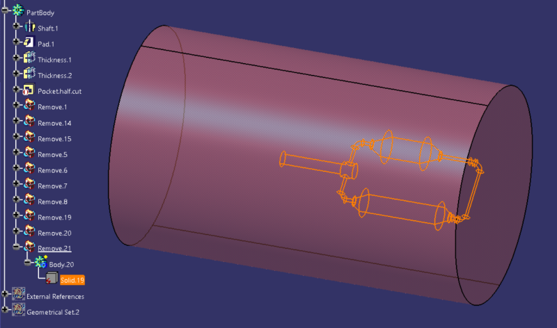

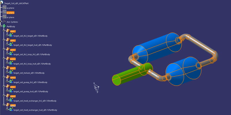

I am building an assembly with sub-assemblies and parts. In order to do that I made a "base" part, a Skeleton where I created many parameters and all sketches to later copy-paste them in the parts with links. I tried to be as tidy as I could.
The product is pretty compact, I am designing the air around the parts. So there are plenty of "zero contacts".
To model the air volumes I create the envelope (with the sketches from the skeleton) and then copy paste with link the bodies of the parts which are inside. Then with a subtract boolean operation I take all these bodies out leaving me to have a tight design.
There is a part (a 125 microns pipe, divided in 4 separated sections) which is giving me lots of problems, when executing a clash analysis it is always there.
This doesn't make sense to me, if it was removed from the volume it shouldn't be there.
Attached two captures of the clash analysis.
I tried to repeat the operation, divide the problematic part in small ones, check the links... I don't know what else to do
Anyone?
thanks

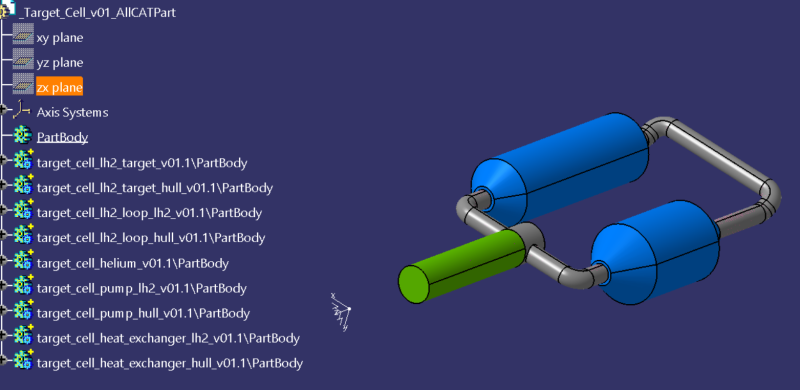

Here are the files:
https://seafile.rlp.net/d/46055ef11d/
the main assembly is "__16-02-19_setup_10.CATProduct"

I would try something like below (I wouldn't use assembly features, but maybe is just me, learned with some companies rules...).

So if I understood correctly:
- You have created a Part from a Product
- You have made a body (adding all the bodies in the created Part)
- You have subtracted the this Part from the "cylindrical part"
The problem I see is one loses the links when creating the Part from the product.
PS: I am very interested in knowing about company rules regarding Catia. Is there any public list of any company? Or a list with good practices.
I have heard about the assembly features; in this case is just for making captures with half volumes of some parts. When using Sectioning one can not choose which parts/assemblies to cut (in theory yes, but in the end everything is cut).
thanks!
