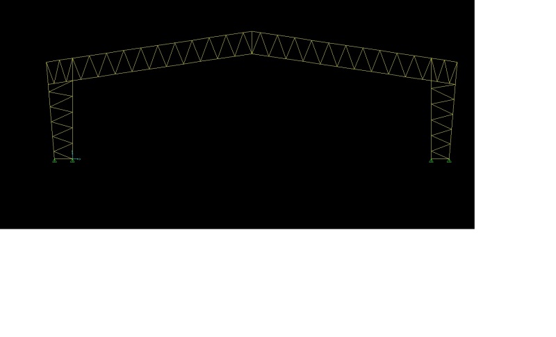

I am designing a theater in light gauge steel structure which clear span is 17 m, length is 30m and height is 3.8m.
So my question is that does this possible in light gauge steel structure by using the Light gauge steel portal frames @ 5m bay spacing as shown below because i don't want to use the trusses in short spacing , however we don't have internal partition walls for strap bracing.
For this scheme C150-1.55 section will be enough for the portal frame???

Why not go with a pre-engineered metal building?

http://scholarsmine.mst.edu/cgi/viewcontent.cgi?ar...
http://mmcengineer.com/DEM_Portal_Frame.pdf

Shahg: Have you researched AISI requirements? What are your thoughts on the MMC trusses?
