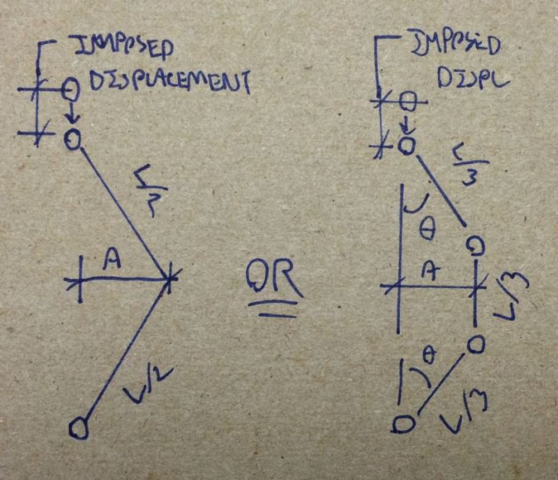

The theoretically accurate solution:
1) You know the 1/2 wavelength for the sine curve = column length - imposed axial displacement. So you can get lambda in the sine wave equation.
2) You set up an equation for the arc length of a half sine wave and set it to the original length of the column.
3) You use the relation established in #2 to back calculate "A", the amplitude of the sine wave.
4) Now that you have lambda and "A", the shape of your sine curve is defined and your done.
Trouble is, there's no anti-derivative for the arc length of a sine wave. As such, you're forced to result to numerical methods like the one that BA mentioned.
Luckily, there's a much easier way that's sure to be sufficiently accurate for any practical situation. Use the imposed displacement and one of the models below to work out "A" in the sine wave equation. This replaces steps 2 & 3 above and get's you straight to a complete equation for estimating lateral displacement along the column.

RE: Post Buckling Deflected Shape
The problem is indeed that you can't determine the arc length. You can apporoximate it however. The sketches that I posted would make for an upper and lower bound bracket solution I think.
Given the information supplied so far, I'd run with this:
1) Use Hokie's equation to estimate A.
2) Plug A into the sine curve equation.
3) Use one of my suggested approximations to fact check Hoki's equation.
On second thought, I'm not sure that I know how to apply the Gaylord equation in the post buckling range (I don't have the book). Post buckling, I'd think P/Pe = 1 indefinitely.
I guess my recommendation is still the mopethod that I proposed initially, using the sketches to approximate "A".

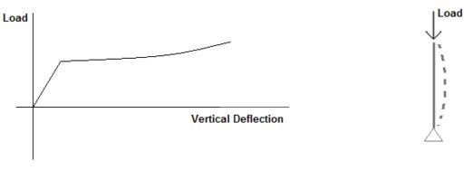

You insert a P/PE ratio (1.001, for example) into the Gaylord equation and solve for δ. The result should be accurate so long as δ/L does not exceed 0.25 and the column is slender enough to remain elastic for the associated δ. For example, for L = 10'-0" and P/PE = 1.001, δ = 3.42 inches (δ/L = 0.0285).
Right, but I've been interpreting this as essentially an imposed displacement situation. What value does P/Pe take on when you've taken the column to, say, buckling plus 3" of additional imposed deflection? My understanding is that load doesn't increase much beyond Pe in a slender column with further imposed axial displacement. Lateral displacement, however, clearly would.
I do not have the Gaylord book, but how can there be a deflection associated with a load above PE? After the column reaches buckling load, deflection rises without limit and the column fails.
BA
To quote from Gaylord & Gaylord (p. 191):
"The value of P at which a straight column becomes unstable is called the critical load. When the column bends at the critical load, it is said to have buckled. Therefore, the critical load is also called the buckling load. At the critical load the column is extremely sensitive to increase in load, in the sense that a very slight increase is accompanied by a large lateral deflection. Thus, if the critical load P = 4K/L for the column of Fig. 4-1a by only 2/3 percent, delta is 10 percent of the column length L (Fig. 4-1c)". Figure 4-1a is two rigid bars of length L/2 connected together by a rotational spring with a spring constant K.
The equation provided previously is an approximate solution that provides very similar results for lateral deflection to the two-bar with rotational spring model.
