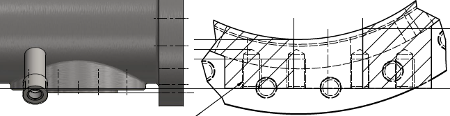

On a side-note; would the partially tapped bolt holes of the below example of a 'flanged' nozzle (which is an integral part of the shell - not attached by welding but machined from the same piece of bar as the shell) also be considered to fall under the UG-43(d), when it comes to minimum required wall thickness between the shell's ID and the end of the bolt hole?
RE: Partially drilled holes in Flat Cover ASME VIII-1
XL83NL, looks to me like this is specifically addressed by UG-43(d).
