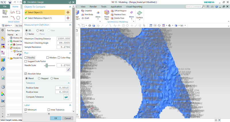

Hi, i am trying to call/use the deviation gauge analysis tool in NX Open to measure the distance between a set of surfaces and a set of facets (STL) imported in Siemens NX.
Is there a way to have access to have access to a numerical value describing the distances between the couples of points considered by the tool? In other words: whenever i use the DeviationGauge directly from Siemens NX i see the distance values visualized on the screen. Using it in OpenNX, i need something like it. This is for me the analysis result, and it's what i need to use in my code.

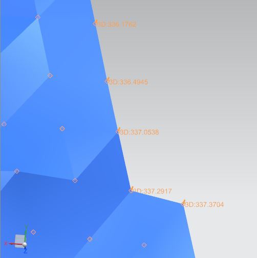

Just to clarify what could be misinterpretated: what i need is a way to access the values in FIG, directly from the NXOPEN code.
The most ideal condition would be to have access to all the values of the STL points, but MAX and MIN values could do.

maybe i need to clarify my problem:
I do have a couple of ideas to get a file output with OPEN, but i can not locate where the data that i need is stored (the results of DeviationGauge, correctly visualized in the NX environment, see figure)!

This is the data that i need, but i can only see/read it in the 3D view of the software. Every evaluated distance is reported on the corresponding point of the STL.

The distances are not actually listed in the listing/information window. The step that i miss to be able to print the data is exactly that. In the "deviation gauge" window there is no option to send the data to the information window (as in the "measure minimum distance" tool, for example), and i don't know how to do it.
RE: DeviationGauge tool - NX Open
In interactive mode ( i.e not running code to do this) , If i leave ( OK) the deviation gauge, it will still be displayed on screen. Then select the deviation gauge and do a Information - Object ( Ctrl+ I) NX will produce the report you are looking for.

It works!!!! Thanks! Now i'll try to call it using OPEN.
I managed to call it from OPEN using the journal. Thank you again!
