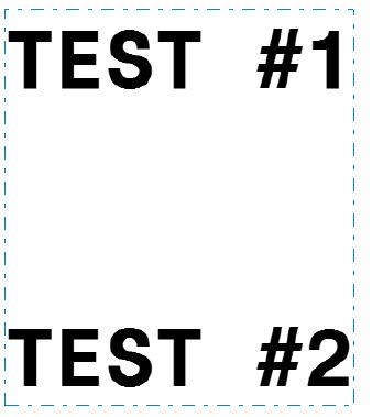

I have the Backgroud_UpperCase_TXT.CATScript from the Catia Portable Script Center that I modified to include text in the main view as well.
The issue that I am running into is that when it changes everything to upper case, text boxes that have text with different formats in it all get changed to one format.
For example, some of the text is bolded and a different size, after the macro is run, all the text in that text box will be bolded and one size.
Is there a way to keep this from happening, I just want to make sure all my text is in upper case, I do not want the formatting to change.
CODE --> CATScript

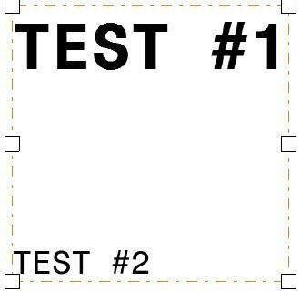

It changes everything to upper case, but it changes the format in a text box that has multiple formats.
I am running Catia V5R23 SP3 Build Number 23 on Windows 7 Professional
I have attached the drawing i used to run this on.
I have also attached 3 pictures.
The way the font looks before the macro, after the macro, and the way i want it to look after the macro.

in fact the substring will help you Get or Set the parameter:
CODE --> VBA
For Each oText In oView.Texts
            CTPmax = 16  ' 16 is the max value of CatTextProperty enum
            ReDim textprop(CTPmax, Len(oText.Text))
            For CTP = 0 To CTPmax
                For i = 1 To Len(oText.Text)
                    textprop(CTP, i) = oText.GetParameterOnSubString(CTP, i, 1)
                Next
            Next
            oText.Text = UCase(oText.Text)
            ' CatTextProperty 8 (catParagraph) and 9 (catPlain) should not be impacted by LCase or UCase
            ' but setting them impact length of text
                If CTP = 8 Then CTP = 10
                    oText.SetParameterOnSubString CTP, i, 1, textprop(CTP, i)
                Next
            Next
        Next
Still faster than manually...
