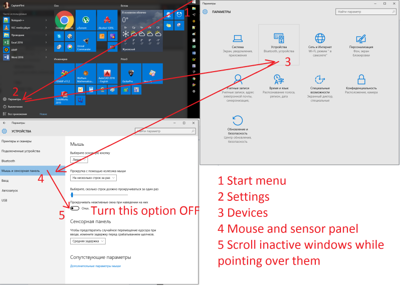

I remember this problem with Windows 10 was commented and solved here in the SIEMENS FEMAP Community:
http://community.plm.automation.siemens.com/t5/Fem...

Yes, that did the trick. I wonder if it has any other (negative) effects. But I will find out with time.
Thanks for your help.
